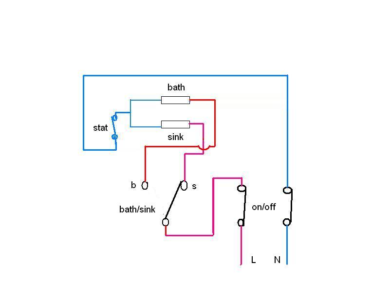

(Disclaimer, I am in no way a qualified electrician and will get someone to look at/do this for me. Just trying to work out what the best approach is).
I'm wondering if I can run two immersion heater elements (3kW each, so 12.5A each) on the same circuit? Getting another circuit upstairs will involve drilling through a 300mm high density concrete slab - which I'd like to try and avoid...
I don't think I can have these both powered up on the same circuit at the same time (MCB is rated to 16A, cable is 32A (I think), and the timeclock after the fused spur is only 16A). And that doesn't bother me - happy to only run one at once.
So it possible to have these wired up so that they can both run on the same circuit, but so that only one can run at a time? Any risks in doing so?
Any alternative suggestions welcome.

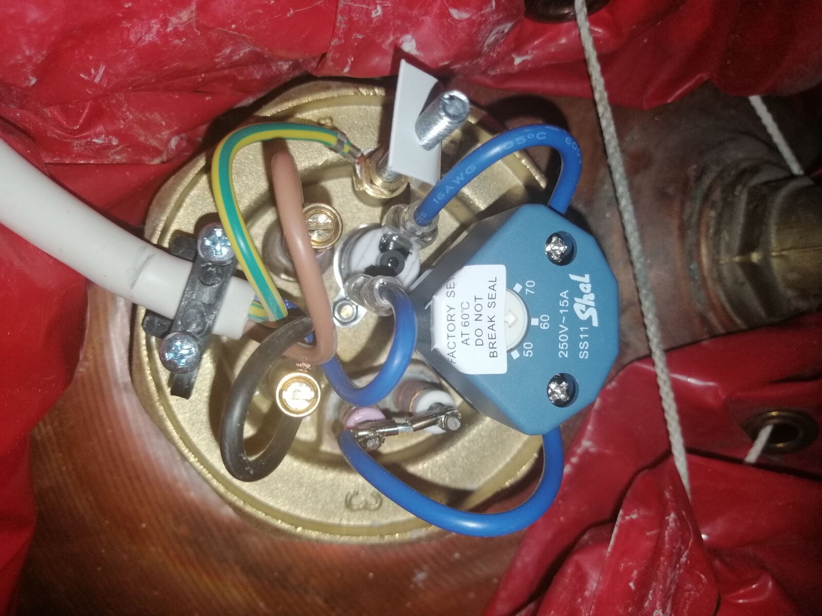

A dual element immersion may (almost) meet your requirements, as pointed out elsrwhere there is a shorter element, ~ 11" heating ~ 35L and a long(er) ~ 24/36" heating ~ 75/115L (more, depending on cylinder diameter and capacity) with a common thermostat switching the neutral, you could modify the "sink" & "bath" and connect them to a timer or whatever to allow only one element operation. The problem with these is that if the 35L is fully hot and you then change over to the longer element then no extra heating will occur as the immersion stat is only the same length as the short element, you would have to use up at least some of the 35L to get the stat to call for heating, even then, you still won't get a fully heated long element heated capacity even though the water at the top might end up say 5/10C higher than the stat setpoint and the bottom maybe 5/10C lower than the setpoint but probably not too bad once you get the longer element heating. In the second attachment, the black cable (sink) supplies the short element and the brown cable (bath) supplies the longer element.
Cheers, I'd seen this image on a different thread in the past (was that your thread, or were you just replying to it?).
I never really understood how it could work well with the stat only being the length of the short element and I'm glad you've confirmed that as being a thing.
I was just contributing to it, its strange but these dual elements were quite common around here and I've never seen anyone complaining about the above problem, I have a 52 year old Santon (dual element) and even though the sink only heats around 28L in a 150L cylinder, once ~ 12/15L is run off then the stat calls again for heat, it has a non adjustable (otter stat) thermostat that heats normally to 58/62C and will cut in at less than 5C lower.
