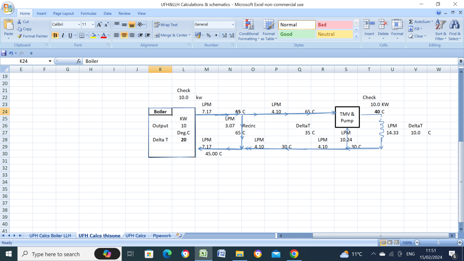

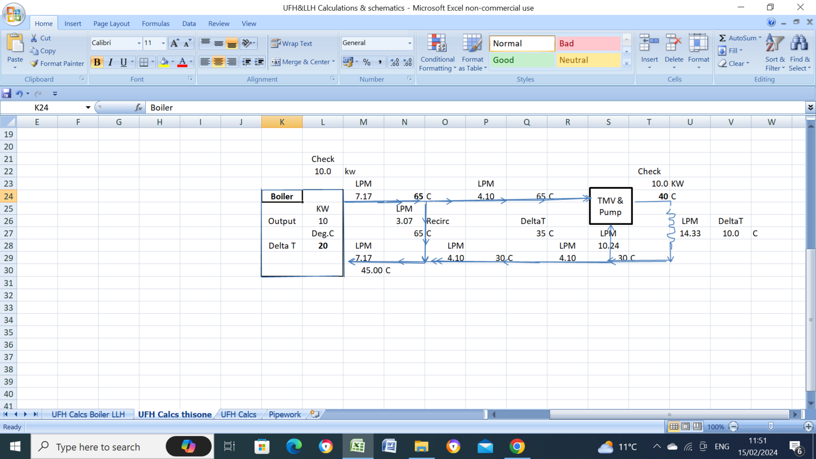

It should also be remembered that when running UFH only with a gas fired boiler that a bypass is almost all ways required to prevent the burner tripping on a excessive dT and constant cycling even if its minimum output is < than the UFH demand.
You can see below with a boiler flow temp of 65C, a UFH flow/return temps of 40C/30C that the boiler would have a return temp of 30C with a dT of 65C-30C, 35C, unless some by pass is used to reduce the dT to say 20C.
Thanks! So what would this by-pass typically consist of?
I ask, because I have all UFH on the ground floor and normal rads upstairs (on a Y Plan). This was installed by a heating engineer (not me) as part of a refurb 11 years ago - and I am not aware of any components that could be deemed to be a by-pass. Do you mean some sort of additional expansion tank?
Next time you are running on UFH only (ground floor) make a note of the boiler flow and return temperatures, d.40 & d.41, if the difference in these, the dT, exceeds 30C I think, but certainly if it exceeds 35C, then the (Vaillant) burner will trip and will not refire until the anticycle time has elapsed.
The by pass can be as simple as a piece of pipe and a valve (thats throttled) installed between the boiler flow and return or you may have a towel rad thats allways on even if the upstairs zone valve is closed as this (towel rad) will act as a bypass as well and keep the boiler flow/return dT below 30C or so.

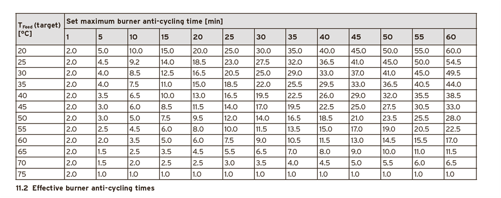

See table, below, this is the anticycle time, the actual anticycle time depends on the target flow temperature and this setting, if the target temp is say 60C and the burner trips (at 65C, like above) then the actual anticycle time is only 3.5 minutes, far too low IMO, I would set that to its default setting of 20 minutes.

There's something not adding up here because a anticycle time of 20 minutes only means that the actual anticycle time is 20 minutes if the target flow temperature was a very unlikely 20C (see table), if the target temp was/is 60C then the anticycle time is only 6 minutes, its where the 20C vertically downwards intersects the 60C (target temp) going horizontally right, your 10C setting only gives a anticycle time of 3.5 minutes and there is no way that the boiler will get away in one firing after that short time as the flow/return temps will be far too high, its more than likely that the boiler is anticycling multiple times IMO, eventually, it will/may get away after 20 minutes or so of this constant multiple anticycling which is what you are seeing?.

If I set D2 to default time of 20, you are correct, that according to the table, with a target of 60C, actual anti-cycling time will be 6. That's what I get in any case with D2 set to 10. HOWEVER, if I set D2 to 20, anti-cycling is rarely 6 (at a target 60C flow temp) - often as not, it is "nope, not firing ever".. Now while this seems bonkers, the firmware on this board has been reported as being freaky before: https://vaillantcyclingproblem.blogspot.com/2012/01/anti-cycling-mode-and-d2-parameter.html?m=1
Bottom line: With D2 set at 10, the result, is as if it is set at 20 (for my flow target temp of 60C).
