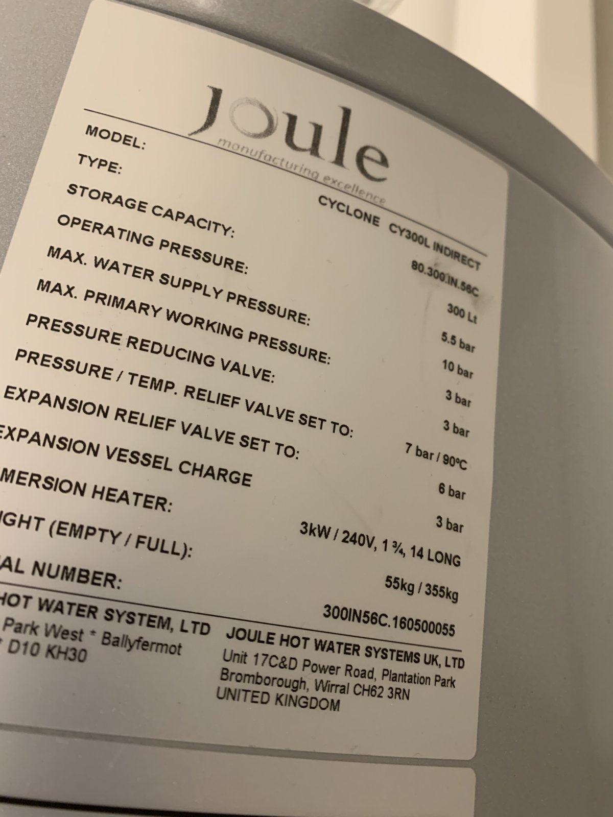

The dataplate is usually to the right of the Joule sticker and has lots of numbers.

Hi Dan, below is the dataplate info. Loop 9 is for “Bed 3” which isn’t helpful as it’s a 4 bed house and most of the rooms are the same size!

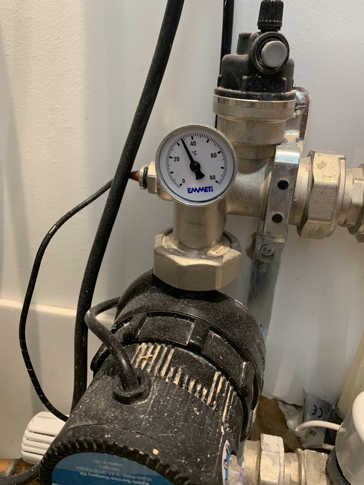

Hi, the heating has been running since 2am (having gone off at 10pm) last night. It’s not particularly cold outside and whilst topping up the boiler seems to have nudged up a few rooms a degree or two, some are still at 19 degrees now - considering heat has been delivered for 8.5 hours, this doesn’t seem right.
Do I need to increase the blend/mix to get the water temperature slightly higher?
Here are pics from this morning - is that dial showing the temp of the water? Do I need to twist that white knob to increase water temp?
I couldn’t find an overheat stat to see whether that’s just been set low.
