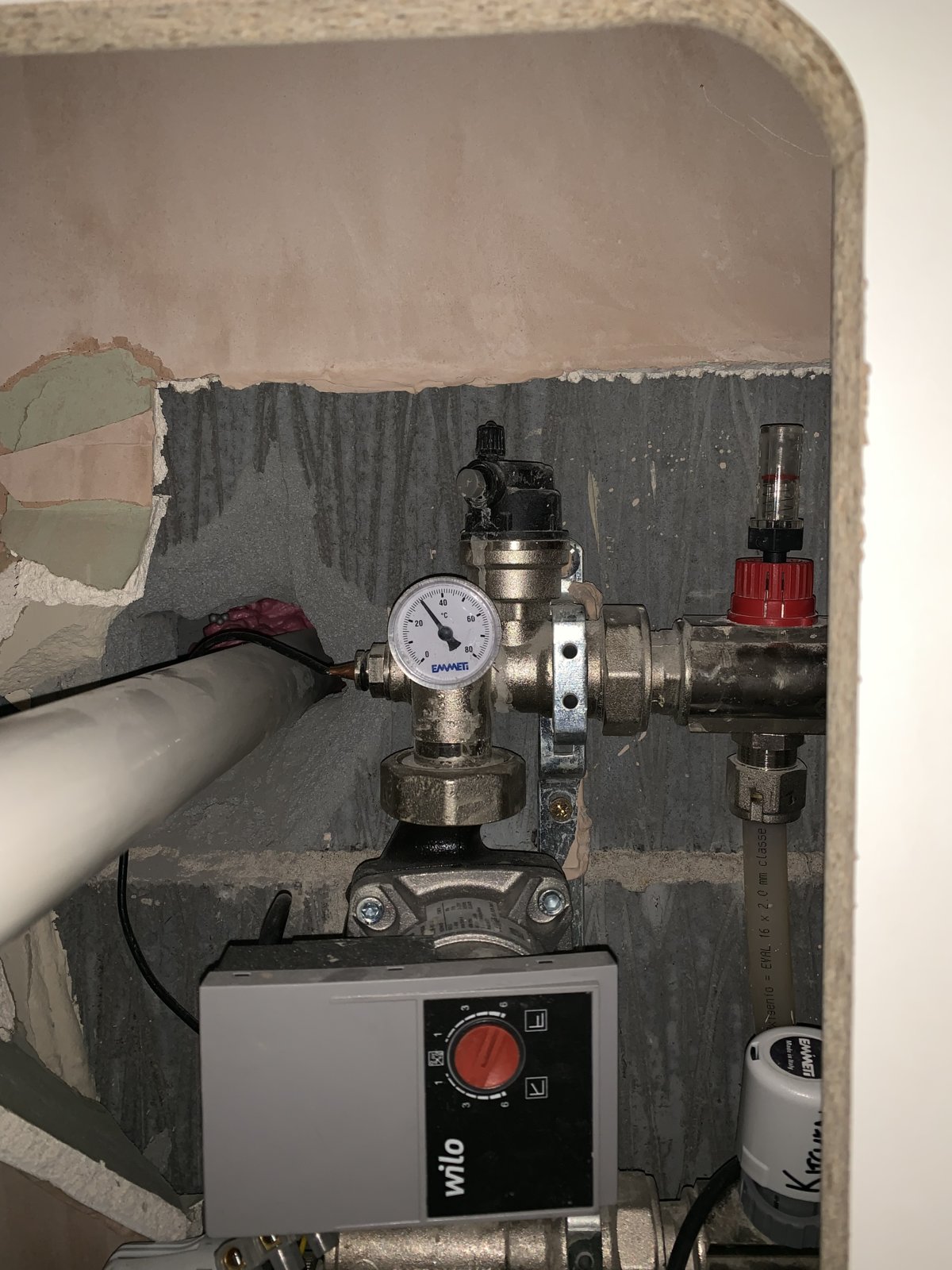

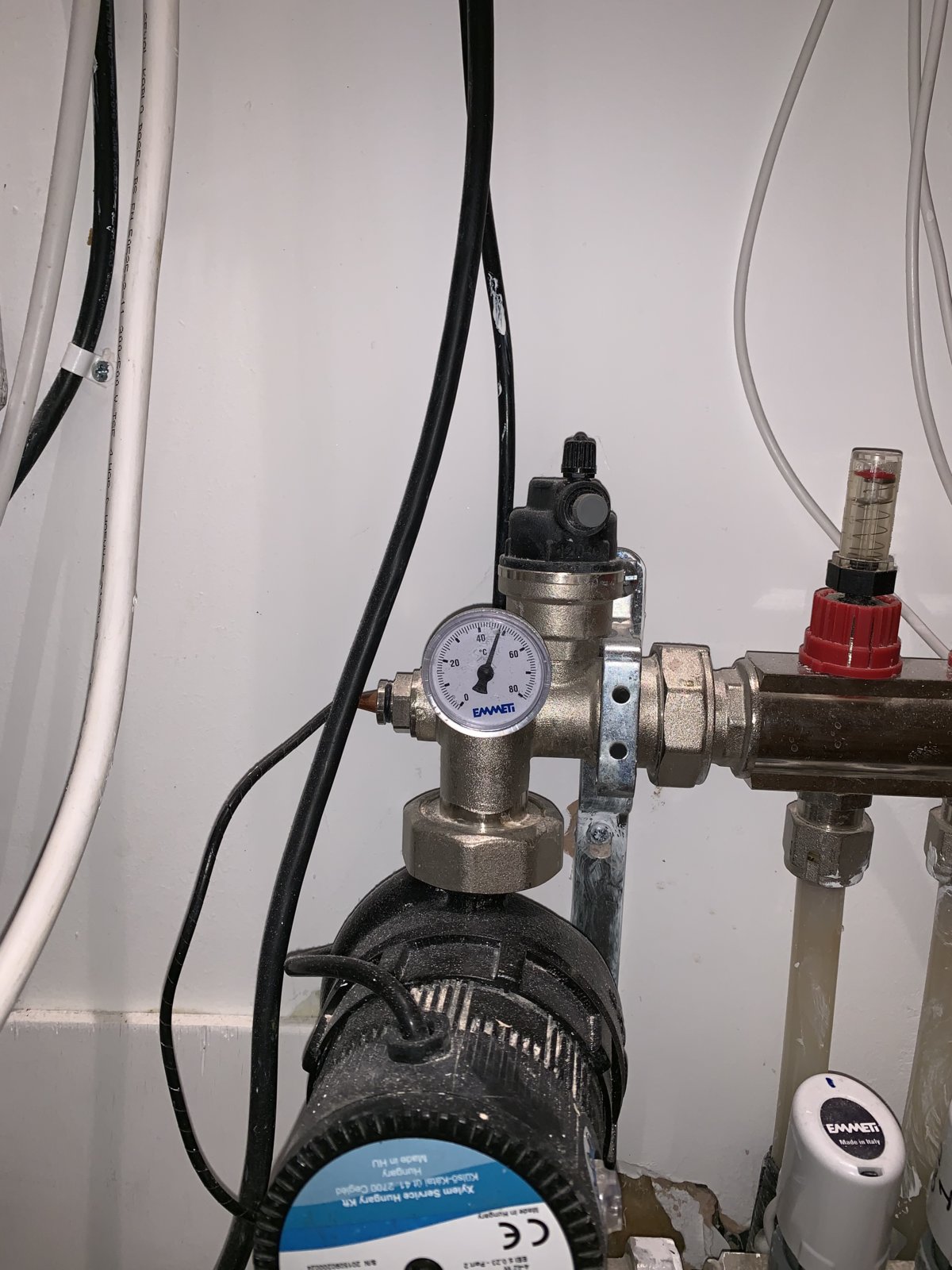

The picture you posted shows a temperature of only 35 degrees...it's normal to run at 45 to 50 degrees.
Ah I see. Just taken a pic of the gauge on the upstairs manifold and it’s running at closer to 50 now (some loops are calling the boiler).
The downstairs manifold is in the second pic below running at 35 (no loops currently calling the boiler).
