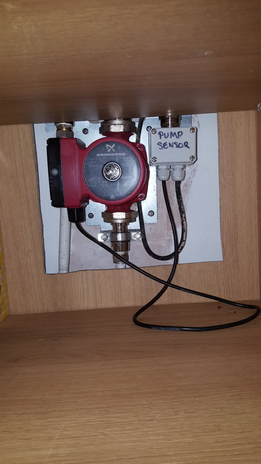

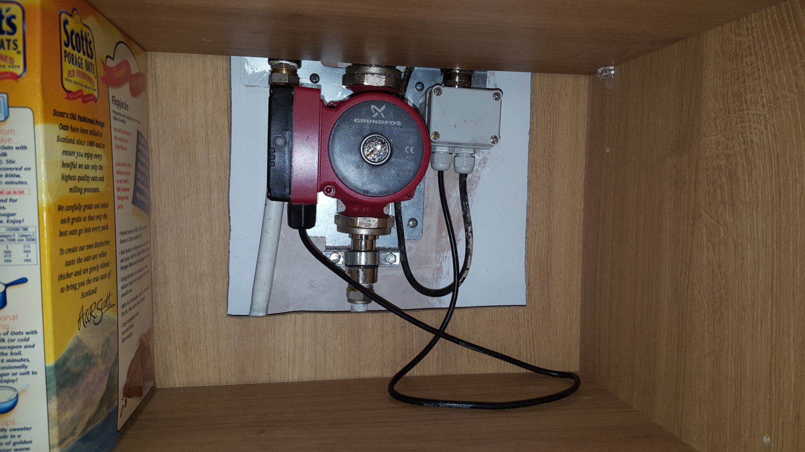

I have a single zone / single loop under floor heating setup in my kitchen.
The original pump fitted was a grundfos upm3 auto l pump.
Hi there, I had a third plumber come today. He believes the problem lies with the pump sensor (box in photo).
There is no branding on the sensor so he is unable to replace it with another one. He has suggested removing it all together and advised that its am extra precautionary measure and not really necessary with the room thermostat and blending valve.
Before he comes back to remove the sensor, can anyone advise this is correct and removing the sensor will not cause any issue?

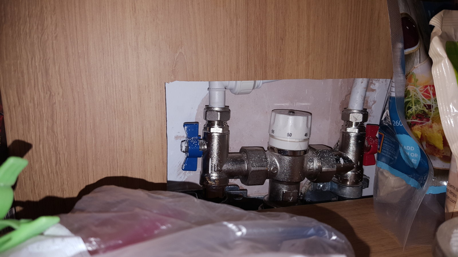

Is anyone able to identify from the photos what the brand of manifold Is? There are no markings whatsoever on it.
Potentially it may have been bought from Screwfix or Toolstation in January 2016. These companies only sell John Guest manifolds. Can anyone confirm this looks like a John Guest manifold?

I've now found the manifold model by googling images. It's a Reliable ZL2532. They don't provide spare parts so looks like the whole manifold needs replacing.
