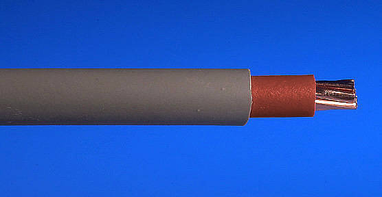

shall not be over-marked at their terminations for single core is quite expletive, as does bi-colour combination green-and-yellow shall be used exclusively for identification of a protective conductor. Singles designed to carry 230 volt to earth not inside an enclosure are double insulated 1708102398726.png so the colour is only shown at the terminations. This is not the case with earth cables, I have used these 1708102578401.png a lot with earth cables, and would not want extra thick insulation. Often laid on tray work, and used to earth the tray, with multi-core I have in the past where damaged opened them up without cutting the cable, and there is no reason why one should not tap into the earth core, UK talking about 150 mm² not 1.5 mm² and I was well aware of where they run to and from.
