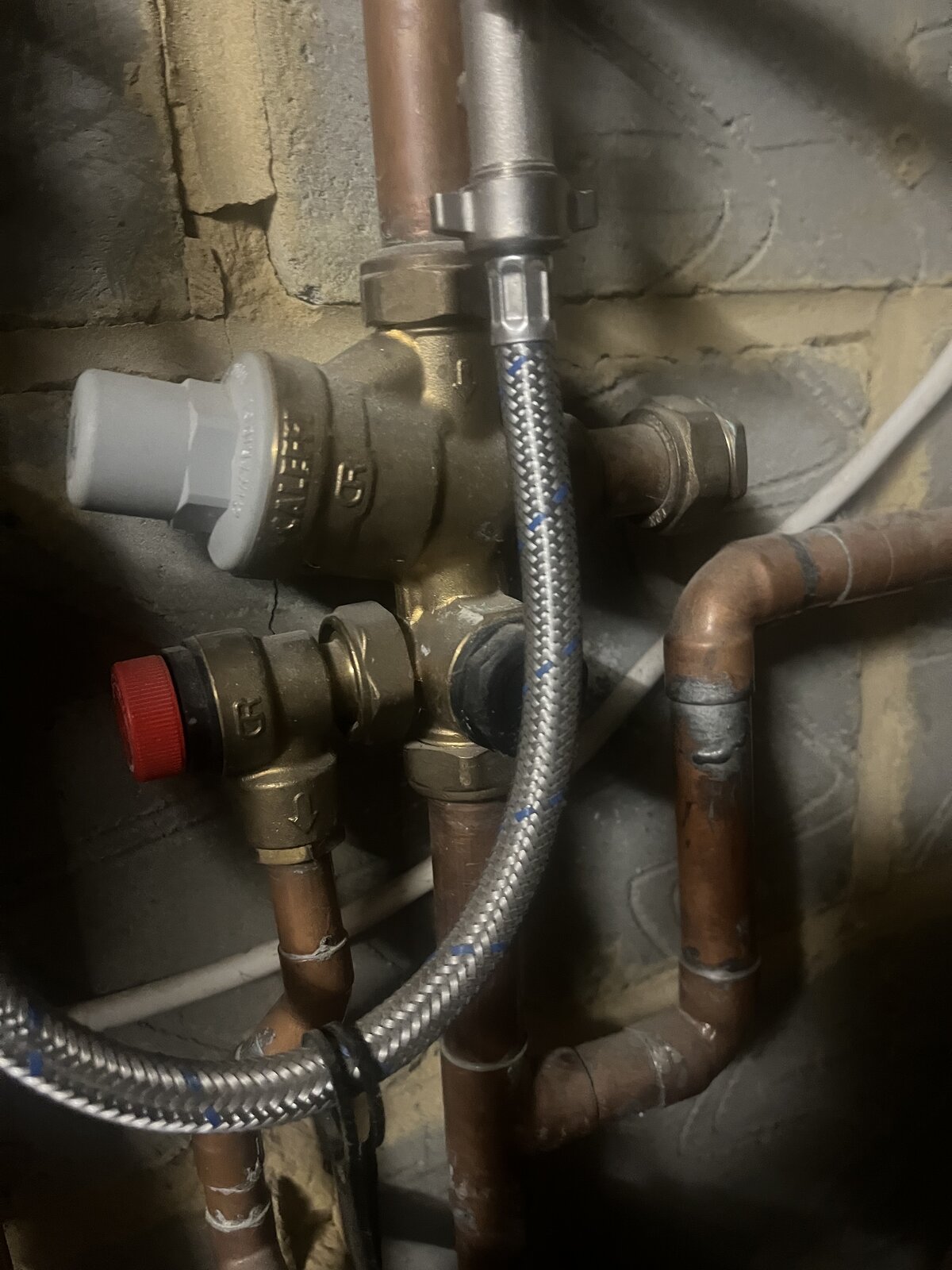

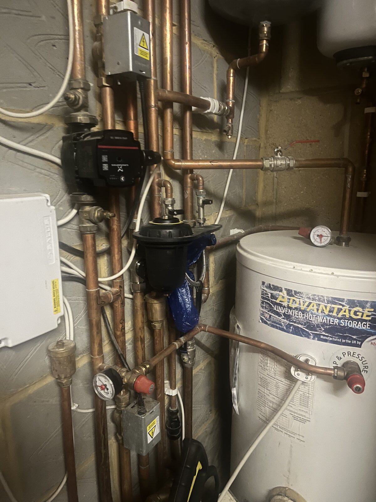

No, only a leak can allow water to escape from the system, if it isn't the PRV. The only other option would be through the HEX in the boiler and out through the condensate but again your engineer should have checked that. Pinholed coil would push water into the system if the unvented was under mains pressure so shouldn't be that.
Pic 2 in the mains water to the unvented and nothing to do with the boiler pressure.
