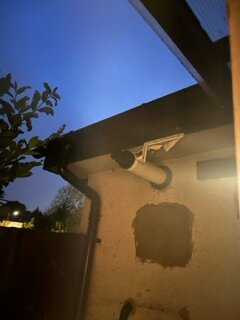

1. when system is not running, the pressure gauge shows ZERO bar (whole day central heating was on at 19'c), when i started the central heating to 21'c today the pressure is automatically increased to 1 bar with in 5 mins. does this indicate a leak? if water is escaped somewhere i wonder how pressure is increasing one bar.
2. i also noticed out side of the pipe connected to boiler (Worcester Telescopic 350 mm - 570 mm Horizontal Flue Kit) is dripping dot dot when heating is on and stopped dripping when heating is off. what does his indicate?
No,
1 ) Your pressure expansion vessel probably needs pumping up or replacing.
2 ) Your pressure expansion vessel probably needs pumping up or replacing.
No,
I disagree, I think the expansion vessel probably needs pumping up, or replacing.
