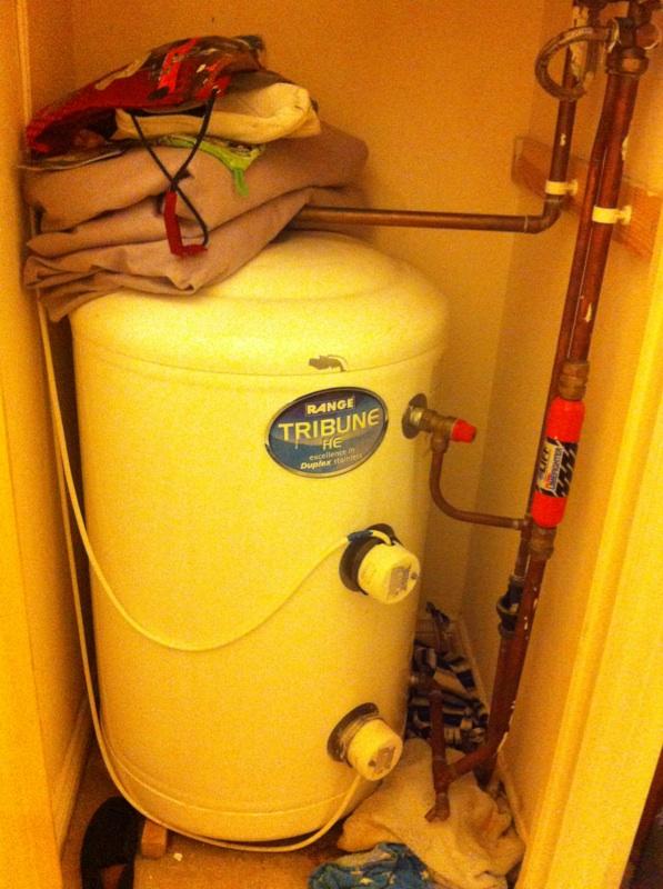

I have an unvented cylinder, it is a range tribune he. I called a plumber to look, so far he has changed the temperature relief valve which is on the side of the cylinder and also tookthe expansion vessel down and checked. He said there was no pressure in the expansion and has reset it to 3bar.
All this work and water is still going through the tundish even when i am not heating water. When i turn my immersion on there is a loud hissing sound.
What should his next steps be as i dont want to keep paying him to change parts that arent required.

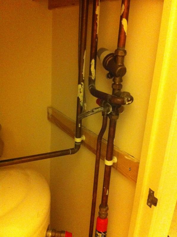

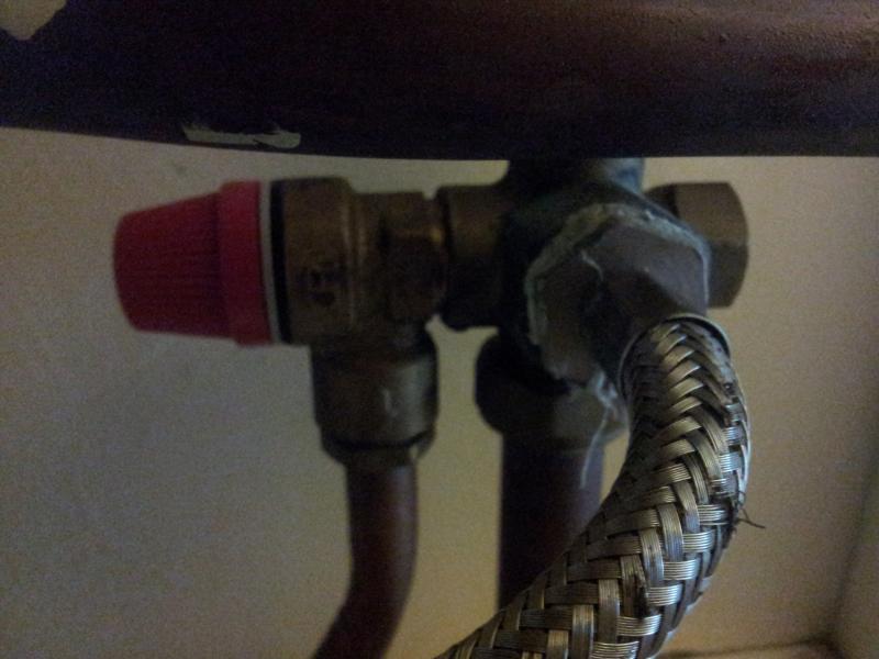

You have two relief valves, have you been able to identify which it is that is passing water?
Your plumber may have changed the wrong one. It is possible but unlikely the pressure on a relief valve is set too low.
The loud hissing on an immersion heater is a problem. You could disconnect each in turn to see which it is. If an immersion boils the water it creates a problem with both temperature and pressure. What did the plumber say about it?

The mains PRV is set at a standard 3 bar - that should not be a problem and in any event the PRV you have is adjustable and can be serviced. You can even stick a gauge on it to check the downstream pressure.
You have not answered which of your two T&P relief valves are passing water. They both discharge into the same tundish and one of them is opening - Please answer Which one?
