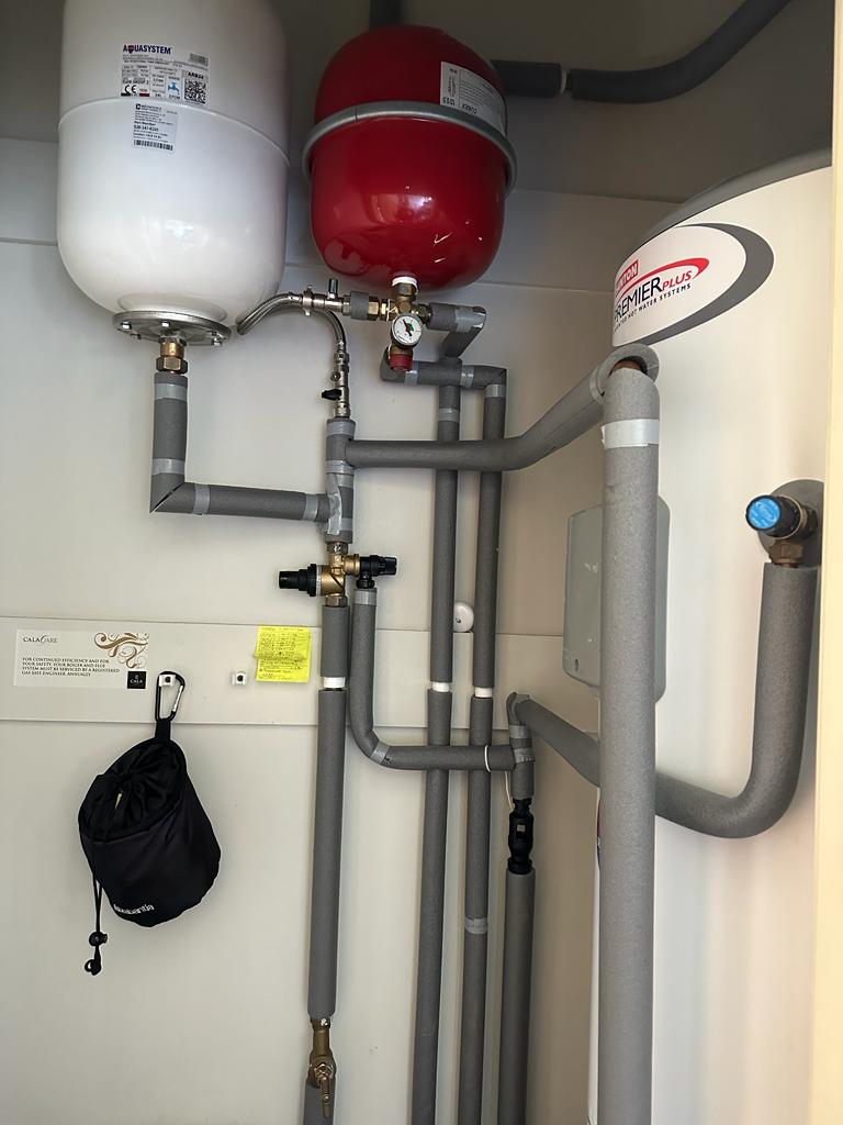

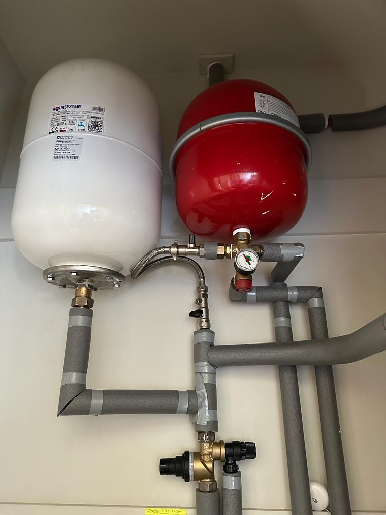

Can you post a close up view of the new valve set including where the E.vessel pipe is teed in,

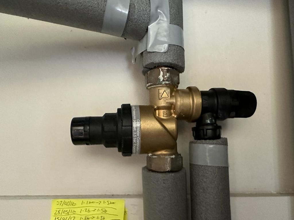

No filling valve is closed off to the boiler system - as you can see.
The tundish has been leaking consistently since Jan when i noticed this. Even after fitting the new group valve i was still getting the same cold water leak in the tundish when hot water heats up.
Yesterday they took the pipe work off the TPR and confirmed that the tundish leak was definitely via the group inlet valve; then put things back together. Then the re-checked the EV i.e. turned off the mains inlet to the system, opened hot tap to take pressure off before taking pressure readings on the EV. The mains inlet was turned back on and hot tap running....probably as much that took place.
Was then advised EV is no good, and obviously the cause of the tundish leak.
So very much confused why now the symptoms are different i.e. no leaking in the tundish? I'm certain that whatever actions occurred yesterday has changed something. Will wait and see what happens tonight when the hot water heats during its 7pm-9pm schedule.

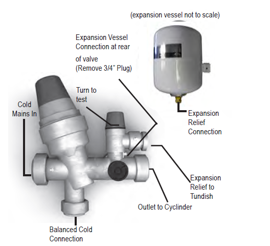

The Valve Set looks a bit unusual to me in that I don't see a port for a balanced take off like the attached, what make is it?.

Group inlet is a santon - https://www.unventedcomponentseurop...4661&msclkid=3361dab7832c189188babef780866570
