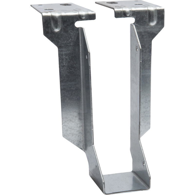

If you are blocking on top, you would use masonry hangers, and no timber plate on top
Just had a look at these woody, they don't seem to have any face fix holes for the timber between the web of the steel. The only holes are on the top where they apparently bolt into the steel beam. Would these require drilled holes to secure into the steel?
Or could a traditional jiffy hanger nailed on the vertical and horizontal be better?
Guessing I'm missing something.
I dont understand any of that!
As you have a wall above the beam then masonry hangers can be used, and these just sit on the beam or above it in to the wall. These would need a timber in the web to allow the hangers to sit against it. The timber does not perform a structural function in this case, but would still need a few bolts through in to the web just to secure it.
Alternatively, you can use heavy duty timber hangers (not speedy straps) and these will screw and coach screw into a timber in the web, and in this case the timber does perform a a structural function so would need more bolts to secure it.
As for painting/priming, its good practice for have this done and good suppliers will do it, but it’s not strictly essential for an internal beam.
Get yourself a can of red oxide and paint it.......it could rust through in 100 years :)
It's more the point that both the structural calcs and building control have requested two coats of red oxide primer on all steelwork, but thanks for your input.
(y)
Yes I was only joking, it is best for steels to be painted in red oxide, it is certainly best practice........ the structural engineer and building control will put that on their drawing by defaut.
Internally there is a chance of condensation and damp causing a bit surface rust.
Thanks Woody,
I've included a photo to show what I saw.
Hopefully it clears it up. I believe that the builders are planning to install the joists and floor immediately after the steels are in place so that they can start the first floor brickwork.
I noticed that the masonry hangers say to either top fix by using a hilti nail gun or to have a minimum of 670mm of fully cured masonry above them before they will accept any loading. That was the main reason for the worrying about securing them down. Is this the case?
