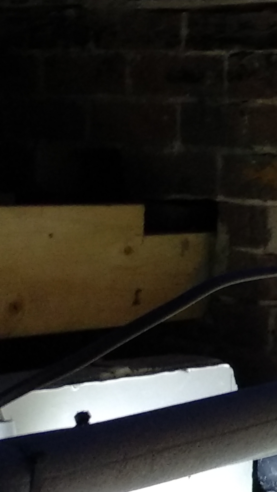

The joist pockets into the wall of the house have been made but i've seen him patching them up with bricks laid vertically and bits of mortar, should I be accepting this? I was thinking it would be a snug fitting cut section of 7N block going back in for a tighter fit or am I being fussy?
Also, two of the joists have been notched 50mm deep by 150mm long where the soil pipe runs across them, I've since rerouted the soil pipe to a better position so it doesn't interfere with anything however the notches are still present. Will these be able to be repaired? or shall I ask them to replace?

Not a builder but the vertical bricks should be fine as long as they don't fall out,
The joist notches might be outside the prescribed limit, were they approved by an SE or just put in and hoped? It's hard to repair but i did have some success with ancient over-notched joists by adding strutting and plywood sisters, the bouncing and vibration is a lot better now.

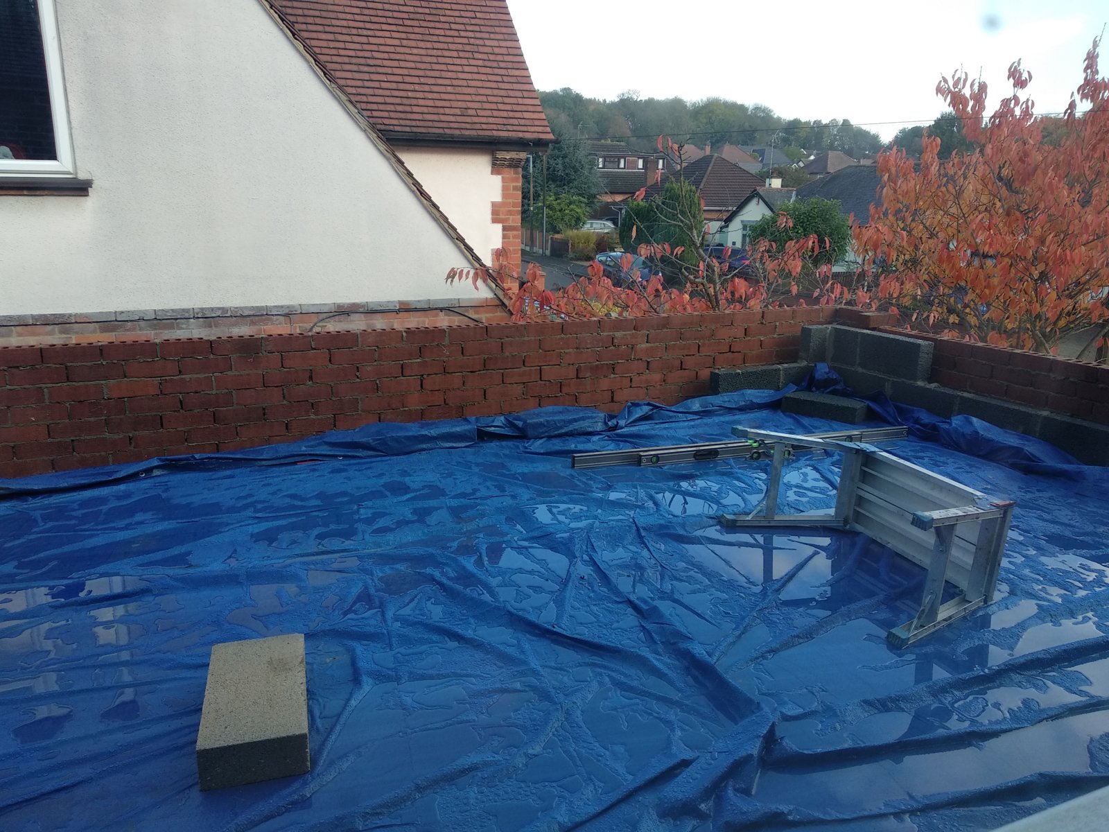

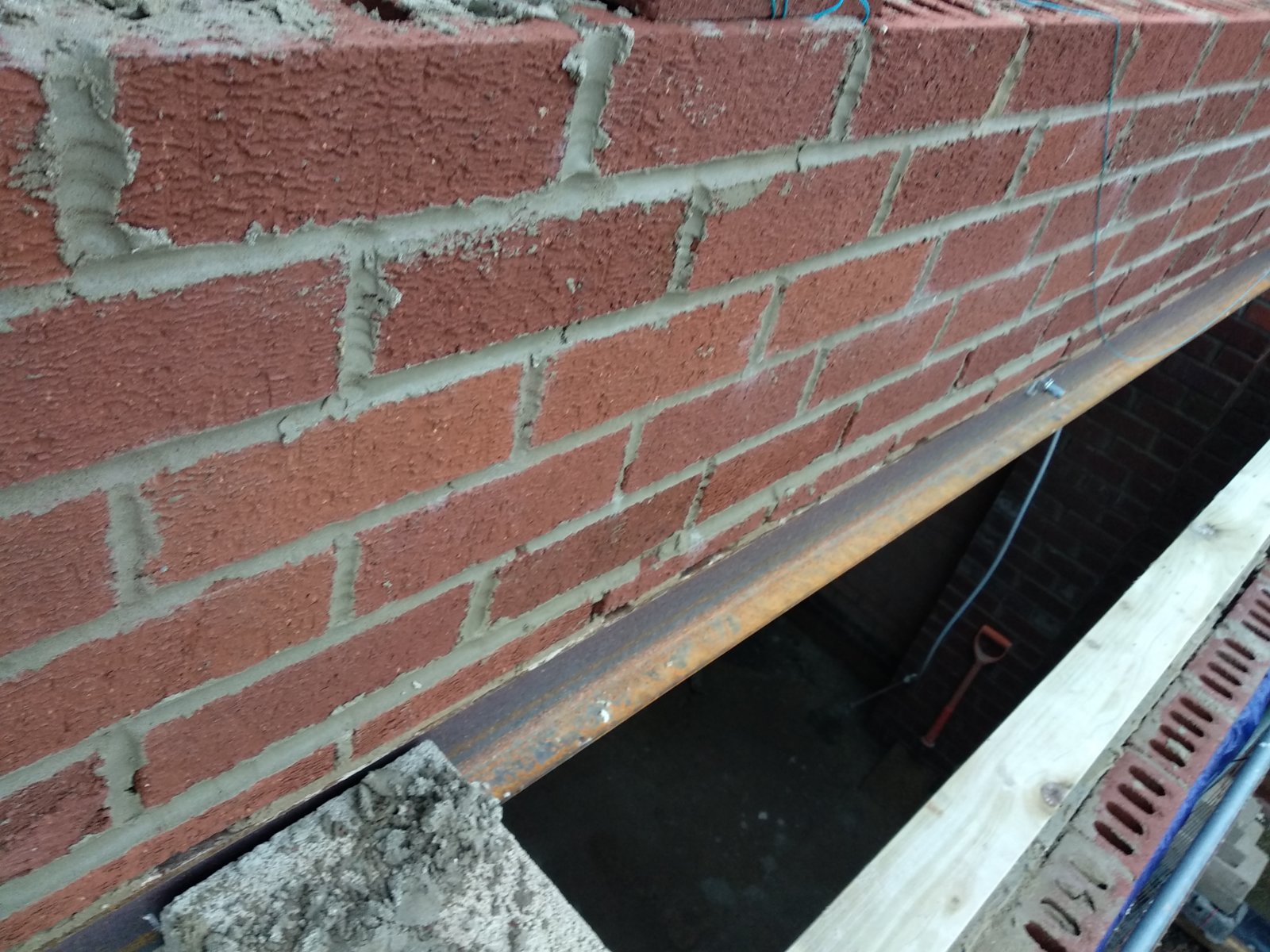

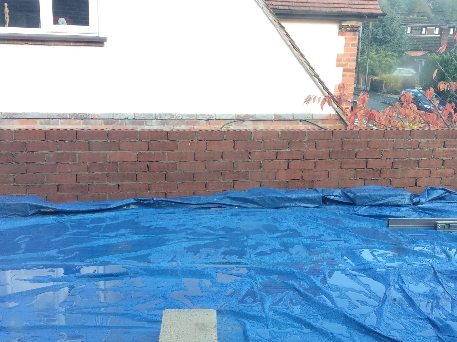

Morning all,
Brick laying has started (between the rain),
We're upto about 9 courses but we have noticed a difference between the two builders laying methods.
The first one is laying full beds of mortar front and back and doing a tidier job whilst the second builder isn't and the brickwork looks patchy at the back.
I've included a photo to try and show it but surely full beds are required for strength?
The rain is slowing progress and is currently coming into the downstairs toilet despite covering with tarps.

is the cost of cement coming out of their own pockets?
Doubt it’s an issue, cavity work you’re angling the bed for squeeze out at the face and away from the back to avoid it going into the cavity. Not saying it couldn’t be done better tho

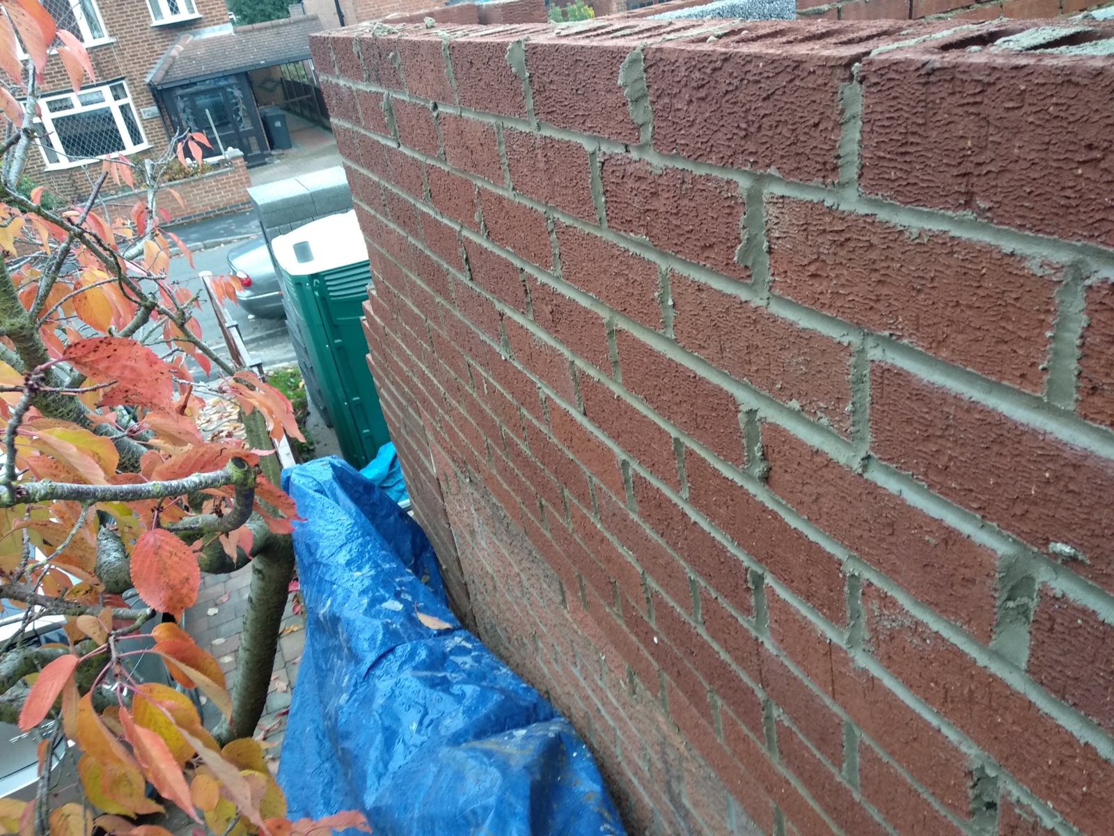

Thanks for the replies.
Have spoken to them today regarding our thoughts on the brickwork and the better one of the pair of builders has agreed to take over the brick laying from now on.
The side of the house pointing looks appalling and although it will only be the neighbours that look at it I can't say that I would wish that on them. We are paying good money for the extension and that sort of standard we can't accept. We can appreciate that some of the brickwork is being done overhand but it's just shoddy.
I've included some photos to show how bad the pointing looks, which he's hopefully rectifying tomorrow.
