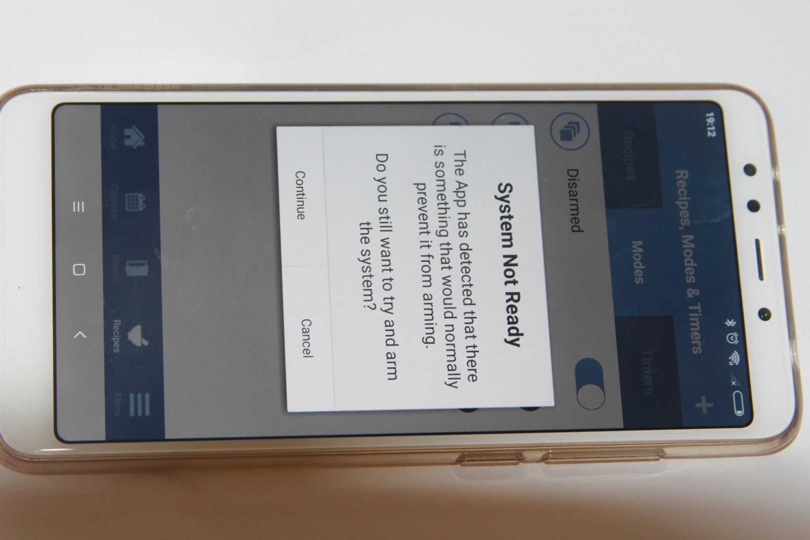

Managed to get smartcom set up and now connected via phone. I can however only use disarmed and part arm, full arm is greyed out. If i try part arm i get "System not ready. the app has detected that there is something preventing it from arming"
Could it be i have alarms zone 17 (my back door sensor) something like r/bat issue

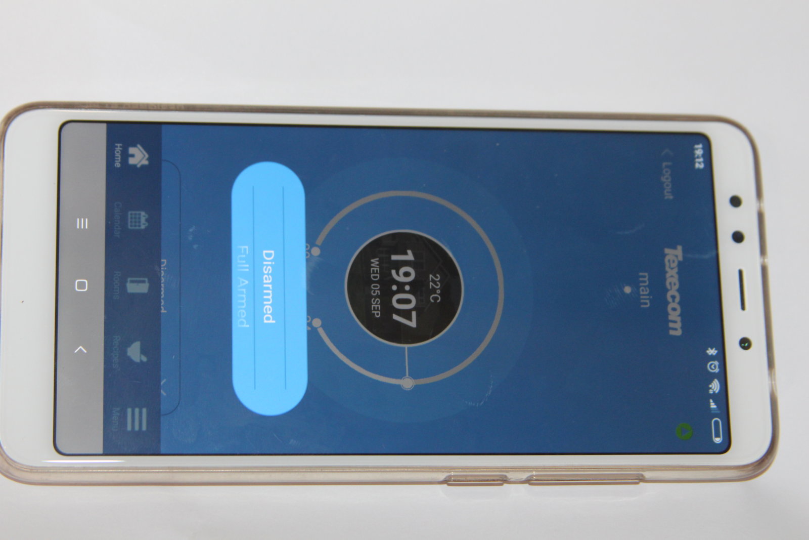

Now getting check your user code is correct when i have logged into app. what a day!
well the app can only arm with a valid user code and with the system not in fault or zone active.
secondly have you setup all the devices and rooms etc in the app.
once you have done all that I would come out of the app and then back in to make sure the system has been updated.

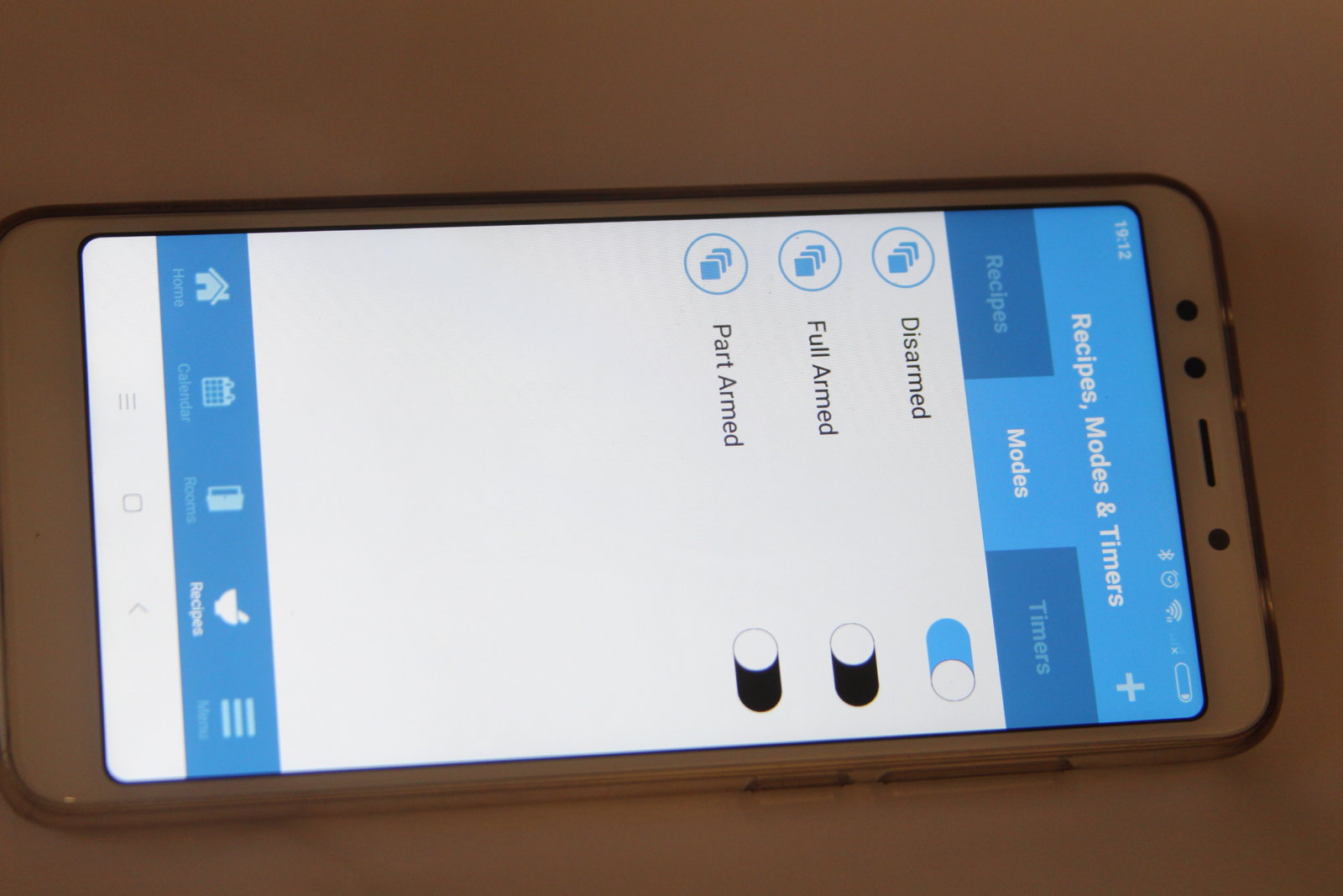

Ok cleared all the alarms, have set up all rooms and can now see door sensors live on app ( not motion though) but still only see disarmed in white and partly armed in white fully armed is greyed out.
Had to go back in and set up again as when i disconnected to use wintex on com 1 everything to do with smartcom was lost. back there now though.
Under Rooms and control i see nothing?

At this moment i am only using one area, that is named along with all my zones.
I managed 1st time round to connect app, but i then disconnected the lead from com 1 so i could access the wintex. once removed and smart com connected again it just lost everything programmed for it, so i did the setup again, now in app ok but not entirely sure what i can do, can't arm it
Some photos

whats showing on your home screen?
where are you when your trying to arm?
are any devices in fault or active?
