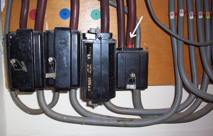

Interesting. I must say that it's not a set of colours I have personally ever seen used for phase identification, but my experience of all things 3-phase is pretty limited, so that doesn't prove a lot.

I seem to recall that when I asked the late-lamented westie about this, he said that, in days of old, individual Electricity Boards used "all sorts of colours"! I suspect that those discs may be 'original', from when the house first got an electricity supply, which must be best part of a century ago.

You might also have wondered why there is a second cable coming out of the DNO side of the 'red' phase fuse (and also why, per my arrow, the DNO's incoming neutral has red insulation!) :)

I saw the red but to be honest it is so common seeing incorrect coloured tails I didn't think it's worthy of comment.
I'd also seen the extra connexion but hadn't revisited the pic since I mentioned seals.

I'm glad I took that photo when I could. The guy who chaged our meter about a year ago seemed very conscientious and did a lot of 'tutting' when he saw that - so the red insulation is now hidden under some grey silicone!
Whenever I post that piccie, someone usually comments on it. The fact is that in 1950, what had previously been two 'attached parts' of my house were sold off as separate dwellings. One of those now gets its (single-phase) supply directly from the pole (via the same ABC cable that supplies me) and the other (once 'my' billiard's room, but now a 5-bed house!) gets its (single-phase) supply 'looped' from that extra connection to the DNO side of the 'red' phase service fuse.

I mainly work on transformers and switchgear at power stations and subs and I've never come across a green phase markers. None of the Grid, WPD or SSE sites I've been to have had green phase markers either so perhaps it's a very old system?
As I said, I suspect that my ones are probably best part of 100 years old, and would presumably have been put there by the East Midlands Electricity Board (now WPD).
