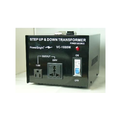

Wife has her eyes on the Rolls Royce of electric rice cookers - more functions than grains of rice in the world :rolleyes: :) , but it's only available in the US. Rated at 700W. I've shown her the size/cost/appearance of a suitable step-down transformer and said pretty much forget about it, but she's hit me back with this...
Ebay link
Huh? 1600W from a wall-wart sized thing that costs peanuts? Well I guess surely it must be an SMPS of sorts with some horrible switched ac output waveform, but then if it works it works. Even mentions 'heating-related' appliances specifically. Anyone reckon it can possibly do what it says on the tin? What's going on with the 50W and 1600W settings - why would that be needed? Maybe it'll do 1600W for 10 seconds then tell you to come back much later :)?

I used a rice cooker in Hong Kong and understand why she would want one. The adaptor seems too cheap. On internet a 1000va transformer costs between £30 and £45 likely need to add vat but could be same if sent from USA plus could have other customs duty.
For heating appliances the frequency is unlikely to be a problem but the centre tapped earth may be and you may need to add fuses.
However have you not tried Hong Kong for same cooker they have same 230vac at 50Hz as we have.
This will have a transformer for the 50W setting and a diode for the 'heating' setting, so it blocks half the AC waveform. It doesn't actually transform the electricity down to 110V, so you are still have the safety risks of exposing a 110V appliance to UK mains voltage. The joys of US electrics.
The modified waveform might kill anything electronic.
It will need to be more than just a diode (a diode will only reduce the RMS voltage by the square root of two, to reduce the RMS voltage to half would require removing three of the four quarter cycles so you are talking a device more like a dimmer in operaiont.
mmm, anything with a transformer upfront isn't going to like a waveform that likely has a substatial DC component.
RMS value for a half-wave rectified supply is Vpk/2, i.e. 170v in practice, 163v nominally.
So if all this thing does is half-wave rectification then it's no good for 110v appliances. The chances of finding out how it works without buying one and testing/dissecting are probably about zero, but on the face of it it's a fraction of the price, size and weight that a real 1600W step-down transformer would be, so I'm suspicious.
No good for the rice cooker anyway, as it can only be used for 15 minutes at a time.
AFAIK they're just diodes.
As Eric says, HK uses 230V, and so is awash with rice cookers of the right voltage.
Are there any Chinese supermarkets near you?
If you are willing to do some work. I.e putting it in a box etc. Have a look here
http://www.airlinktransformers.com/stepupstepdown-transformers.asp
These are auto-transformers that do not provide any isolation between input/output as most do. They are smaller, cheaper and more efficient than an isolating transformer would be. The AT1000 would be more than adequate for the rice cooker.
