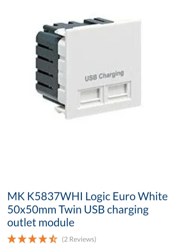

Unless the MK source is provided with D+ and D- and a PD Engine then what you are imagining just can't happen.
Having done a 'big Clive' on a failed socket listed by MK as fast charging and found both outlest were simply multipled together then surely they must have data connectivity.
Which takes me straight back to one device negotiating a higher voltage and the other device being bu****ed. If fact thinking about it; that could have been the problem where it was assumed the failed phone overloaded the socket and it could have been the opposite.
The definition of "fast charging", is technically I believe, anything greater than 9W of power delivery.
A USB charger outputting 5V @2A would class as a "Fast Charger", without any of the voltage negotiation of the USB-C power delivery standards.
I VERY much doubt that the socket in question implemented PD. This requires a complex serial protocol on the data lines. The systems that the wall socket people call fast charging is a combination of different vendors' systems using different value resistors and promoted by irresponsible vendors, plus a load of chinese vendors. The official USB-IF 'Fast Charging' is an option protocol added to the Power Delivery protocol which was developed jointly by the USB-IF and the Chinese regulatory authorities.
I believe that raised voltage is the result of at least one of the non-USB schemes so you could be right. It would be a totally flawed implementation by MK is so, and nothing to do with the official spec.
I have never seen the official USB compliance logo on any of these sockets so they are all to be avoided. I would certainly never go near one, as I prefer not to burn my house down.
Every MK USB socket I have seen has only provided 5V, at a maximum of 3A.
I doubt MK have done anything wrong!
To be fair, their Type-C receptacle is advertising 3A via its Rp resistor, and the Type-A receptacle is advertising 1.5A by shorting its data lines together. But because they are using a common 3A power supply, plugging in a second device can reduce the current available at the other receptacle and therefore reduce the 5V. This is certainly not within the spirit of the Type-C spec. I would have to read in very carefully to see whether there is a get-out for this behaviour.
BG do a double socket with integrated 30W PD. https://www.tlc-direct.co.uk/Products/BG822UAC30.html, should be enough to fast charge virtually any phone or tablet and may be borderline adequate for some laptops.
I think that is the best you can do for a charger squeezed into the middle of a double socket, if you want more than that then you will have to move to other form factors. Knightsbridge seem to do a 45W charger in a square Euro-module format.
