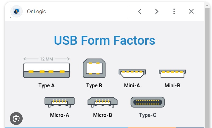

This is factually incorrect. Also the system is still backwards compatible to low speed USB so I don't see how it is different in concept
How can a 24 pin connector mate with a 4 pin connector.
Data sheet for a Socket Type C USB Connector
I think you are perhaps being (uncharacteristically) a little silly, since you must understand that no-one believes, or has suggested, that connectors of different shapes/sizes/numbers of pins could mate together.
It was you who invoked the concept of USB, and Detlef was saying that, in terms of the initial concept (concerning data transfer), there is backwards compatibility of that concept.
Yes, the original concept of USB has been expanded, to encompass new functionality and uses, but the original concept of USB still remains.
Virtually everything technological (and some things which aren't technological) develop/evolve by adding additional (sometimes 'very different') functionality, but also retaining the original concept/functionality (mobile phones are a good example), but there's nothing wrong with that (provided it is done satisfactorily), is there?
