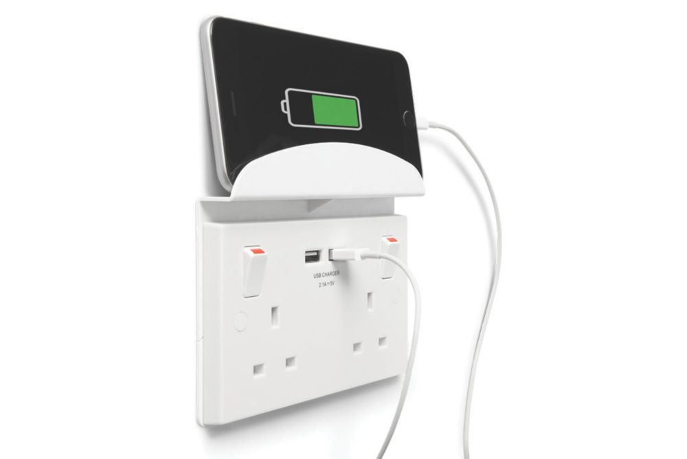

They all seem to pair output sockets so sockets with 4.2A outlets are still only 2.1A per pair, so a 3.1A twin outlet socket can actually charge quicker than a 4.2A if only charging one item, think we have three in this house, one in my own house and one in the caravan. I think I will be fitting more as they remove the need for so many four way extension leads filled with wall marts.
The 3.1A I think only give 3.1A to a single apple device, the other make seem not to use the extra even if there, so 2.1 is ample even shared between devices, at £12 to £13 for the LAP and British General 4 USB output sockets 4.2A between the 4 sockets it means you can charge all phones all the time at home only being unplugged when we go out, before it was a case of taking one item off charge to be able to charge another. I have been considering the socket shelves
