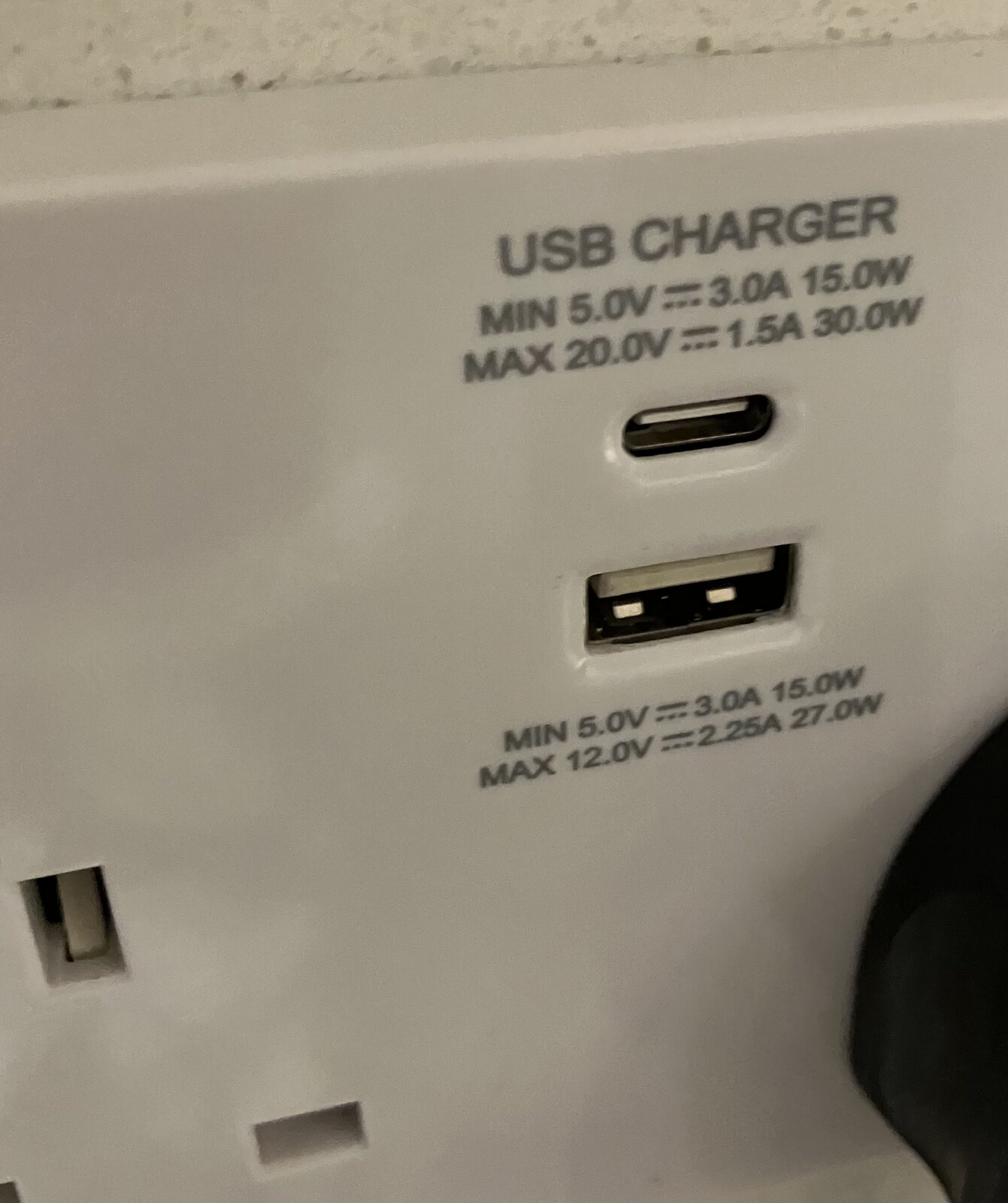

Hi, replaced socket with USB A/USB C version.
The USB A is not powering certain things its predecessor did (5V 1A USB). Sometimes powers up for a couple of seconds then immediately disconnects. Have tried multiple cables with same issue. Are there different types of Micro USB cables for different/more powerful sockets?

What device are you charging?
Your usb socket can deliver up to 15 watts (assuming 5volts if its a phone that your charging) thats enough for a normal phone but for a powerful phone some may require up to 60W

Hi, it’s a wireless charger and various other devices that worked on a previous socket that was labelled 5V - 1A
You don't have micro USB ports.
You have USB-A and USB-C ports.

Are you using both the USB-A and C ports at the same time?
Your socket can only supply a max of 3 amps- if you have a more demanding item plugged in to the USB-C, it may, or may not,knock out the USB-A.
If not, it may be faulty. I am only guessing though.
The specs listed in the Q&A section say
USB A Output - Output power:- 27W Max
Output:- 5V/3A; 9V/3A; 12V/2.25A
It might be advisable to email the maker

Thanks. I have tried a USBA - Micro USB cable that is marked ‘charging’ rather than ‘charging and sync’ and that one works - although temperamental when a USBC is also plugged in.

You (and everyone) should be equipped with a basic "USB Tester"
to measure the
Supplied Voltage
and
Current being Drawn.
These will indicate if the voltage supplied is within "Range" (of 5 V - PLUS a little bit more.)
and the Current drawn, which should drop to around Zero at the end of charge.
It is important to test any NEW or "FOREIGN" supply before using it.
(I once had a 12 V to 5 V USB "Car supply" where, out of the box, the "5 V" output swung between 5 V an 12 V, which ruined the USB powered equipment connected to it.)
They can also indicate loose connections - by Voltage Drop-Outs, when "wiggling" cables/connections.
