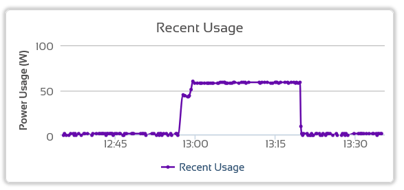

as said the distance boiler to storage tank will make a difference, but the big problem is although these 1724927442811.png are easy to use, immersion heaters tend not to have a plug and socket, so the shower, immersion heater, and cooker, are the three items in our homes which we can't easy monitor power use, and it was not until the iboost+ was fitted that I had any way to measure the power used by the immersion heater.
That's where a smart meter comes in, if you can turn everything else, to off, whilst that one appliance is used. That is how I was able to check my gas consumption - no heating used that day, no cooking done, just the cylinder reheated from cold.
As to stratification, and if a problem, it does depend on if you need a hot water tank that big, and often stratification can be a plus, the Willis system seems to be the best option, at least in theory, and it relies on stratification to work,
The willis system relies on a significant thermally induced water flow through the heating device which (as I understand it) is the exact opposite of stratification where the thermal layers stay firmly in place, rock formation layers are also stratification as are the atmospheric layers around our home.

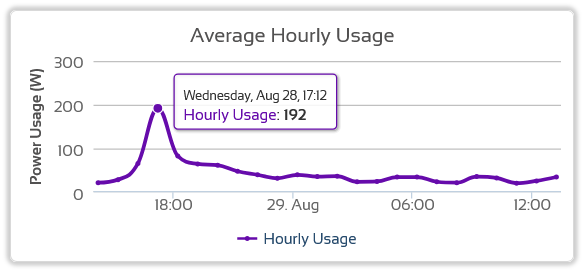

Back ground use is a problem, at moment using my laptop and 1724934332094.png likely one of the freezers is running, and at 379 watt when export is 1724934456359.png why should I worry? Getting oil is a pain, I have to take a torch to see how much we have, and phone up for new supply, the pay for it of course, where electric the standing order is paid each month and I can forget about it.
