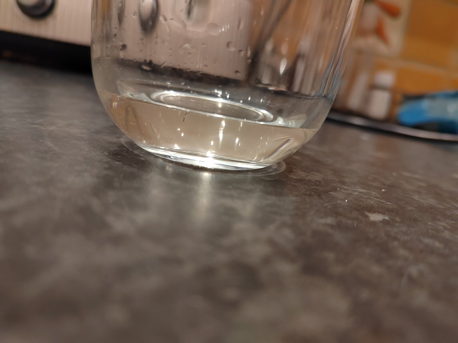

I'm not entirely sure I need a power flush at this stage. I think best way forward before spending that kinda money, see how it goes with the new rads next week, in meantime keep eye if I use heating before new ones are in and see those temps you suggested. I do remember though when I bled the rads, after the air come swooshing out, the water then trickled... It was clear. It would have brownish tint to it if any sludge or build up is present I would expect
Just tried bleeding, no air. Wanted yo double check colour of the water again. I did my rad which has the cold spot and one of in kitchen. This is water that came out. No brown at all cloudy yes, I wasn't expect it to be super clear
I agree, looks OK. Maybe ask your plumber, to just investigate what is causing the problems with that radiator.
