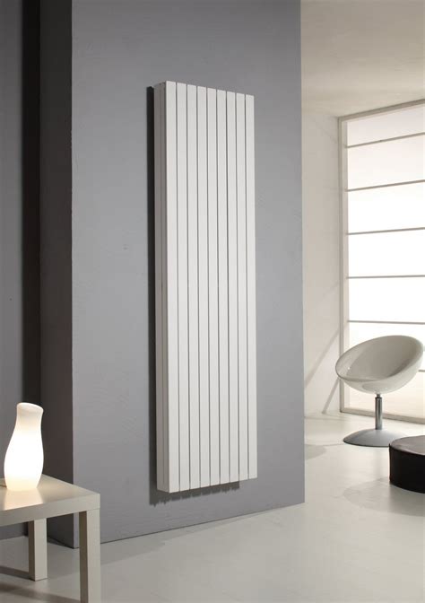

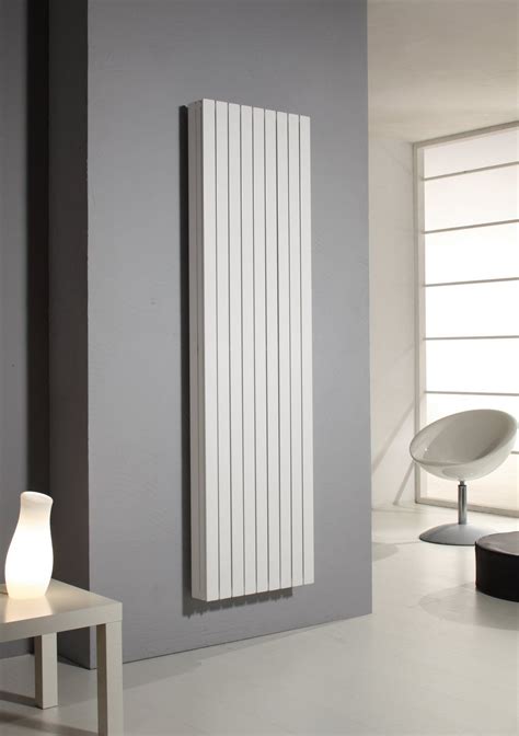

Yes, there are three radiators in the living room where the thermostat is. Each of the radiators have the thermostatic valves and all them are currently set to 5/6 at the moment.
Currently, one of the three radiators are hot, the other two wall radiators (looking like, see photo named ui.jpeg) are not hot more luke warm. Probably because the room is warm enough
I have to say it's finally nicely warm in the living room

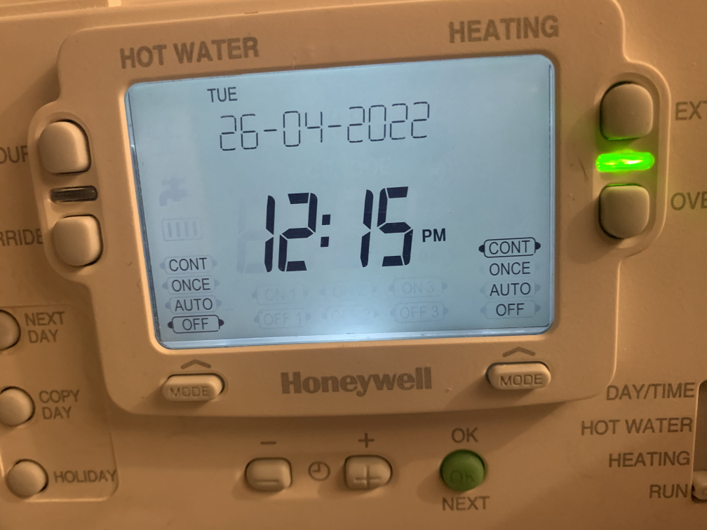

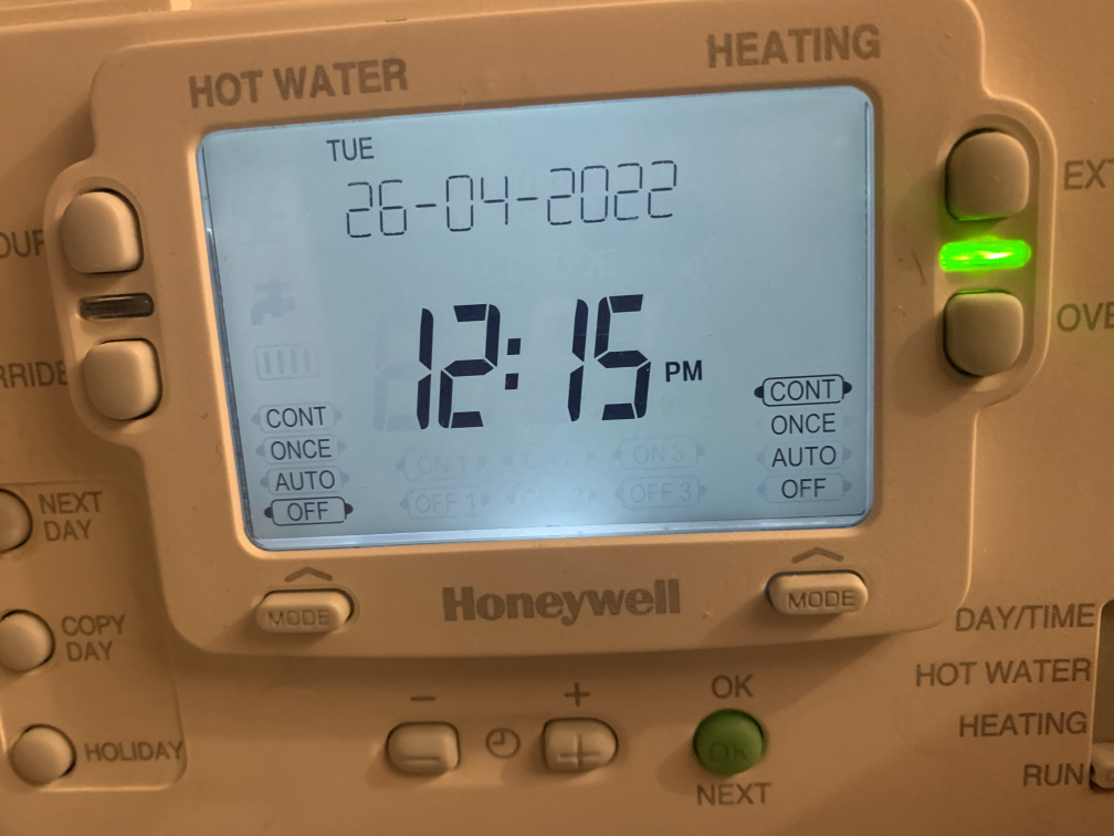

I am a bit confused I did turn off the hot water on the programmer but I still have hot water at the kitchen tap? I have attached a photo of the programmer (see photo named andere-thermostaat.jpg) how it looks like now.
That’s because it’s not heated on demand, it’s stored, so it heats the cylinder to a set temperature, and depending how long you have the progmmer on for keeps it at that temperature until it’s satisfied again or if you only have it on for a short period, then it keeps hot until the cold water replenishes the hot.
