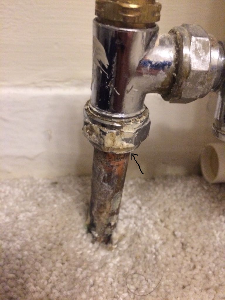

I FOUND THE LEAK!!!
water is leaking from where the arrow pointing. i tightened the nuts but it's still leaking.
what's the best course of action?

That's a compression joint, if the leak is from the, best bet is drain the system, undo, inspect for damage, put some PTFE tape around the olive, back together and tighten.
Then refill
Depend how competent you are, how quick you can work, and how many towels you've got.
You need some ptfe tape between the olive and the lockshield seat. If you release the pressure from the system, turn off the other end of the rad, and then undo the compression nut, you might be able to get the tape in under the seat before you lose too much water.
But if in doubt, follow John D V2s method, and remember to top up the inhibitor afterwards.

I suppose a lot depends on where you live... if a small community means only a few trades and no competition, so they can rule the roost. There’s loads of Plumbers where I live and many who know each other - none of us are conmen, some who know how to earn a buck, but they put the effort in and deserve the rewards.
To sort out your leaky valve should be £80-£100 “if” there are no other ‘obstacles’.
Draining down stops you and your home getting wet/covered in black shyte.
Clean all the deposits away from the connection using back of a Stanley knife/screwdriver/wire wool/abrasive strip... polish it up. Drain system however you need to and undo the nut.
Wrap ptfe around the back of the olive and retighten. Check all other rad valves whilst you have system drained and deal with any you find. Get some inhibitor into the system however you can and refill/pressurise.
