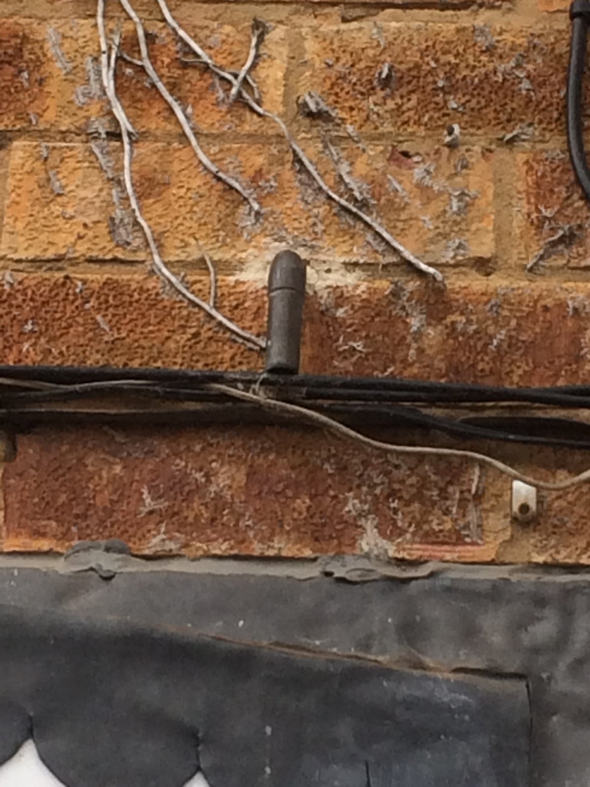

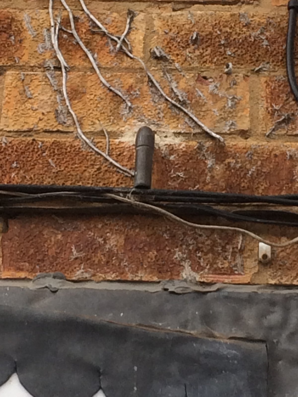

This is the only outlet looking thing I could find on the outside. And this is sitting just below the rad that has the leak

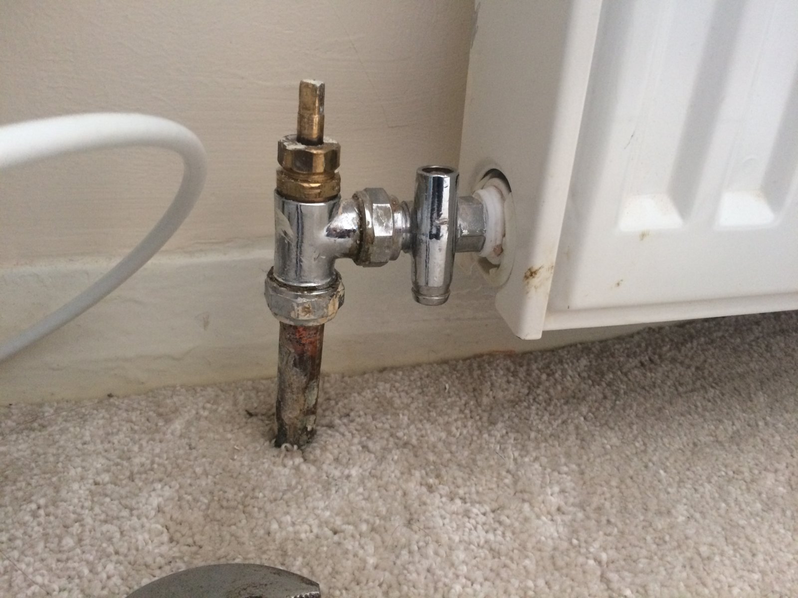

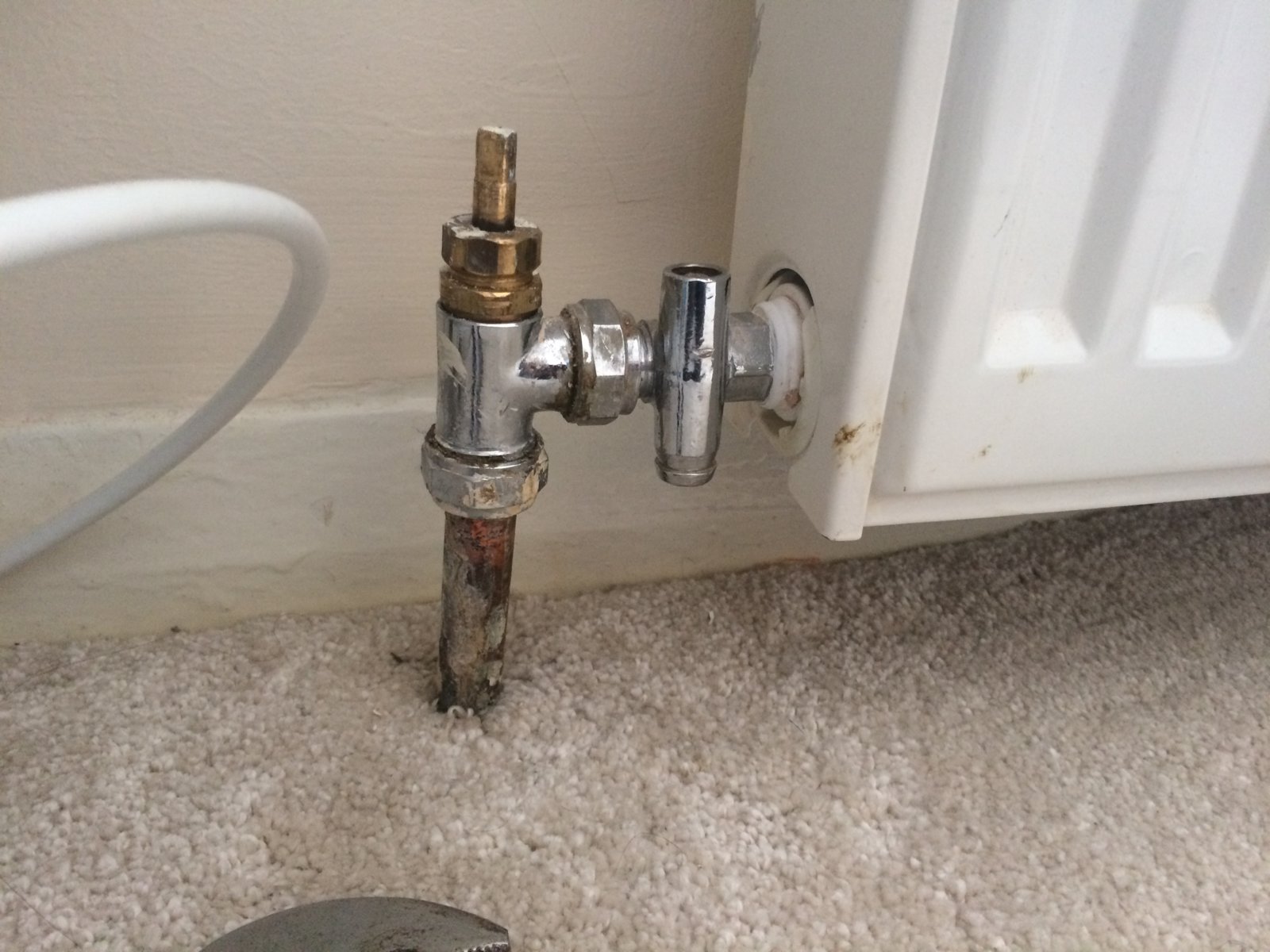

Funtins ,in your pic of the leaking valve ,with arrow, it looks to me like there may be a drain off ,just to the right of the valve and partly out of pic. Can you take another pic showing the full valve and radiator end please. Its the silver coloured bit pointing downward ,that may be a hose connection point. The copper pipe in your last pic looks more like prv pipework ,but it may not be.
Yes mate see attached please
Yep ,that's a drain off point mate. Hose pipe on the bottom and the top will have either a square that you put a key onto ( like when you bleed air from the top of a radiator ) to open the drain cock. Or possibly its a flat bladed screwdriver needed. If you look closely in the top of the vertical section it should be obvious .
That looks like the PRV discharge pipe you were being asked to look for at the start of this topic! :ROFLMAO:;)
yeh its a square, i see it. so if i loosen it, it will drain the whole system? how does it do that if its one floor up?
It won't drain anything below it ,but it will allow you to fix your leak. Have a look at your RAds on ground floor ,for similar drain offs to drain the whole system.
ah ok ok. yeh i didnt see anything but it may be hidden.
ok, so this is interesting.....i tightened the nut again hoping that would fix the issue and it seems like it has. no leak for the last few hours....!!!
