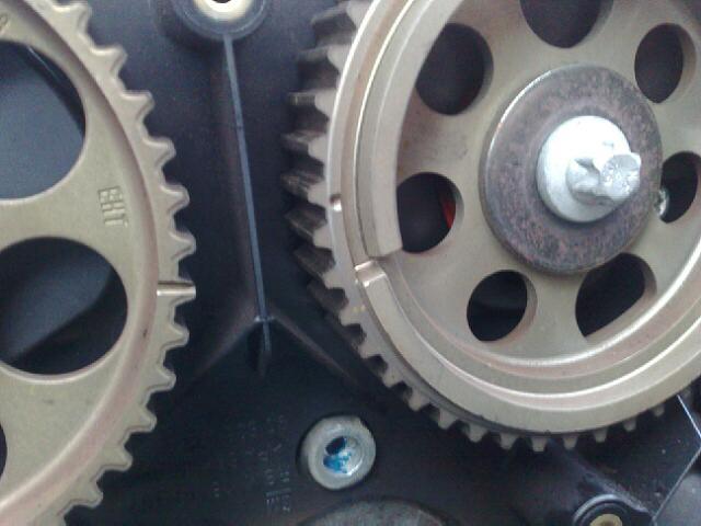

hi there, i have had to do a timing kit on my vectra z18xe as part of the pully broke, i have changed everything over eg water pump, tensioner, pullys etc... but when i have gone to re-time there not meeting tdc by themself, (TOP END) the Left pully is perfect and the right one is slightly off.. am i doing something wrong can someone please help..
i have added an image
looks to me as if those timing marks are in the wrong position, they usually sit facing each other horizontally. Left one should be at number 3 on a clock, right one at number 9 if that makes sense.
i know what u mean mate but when i turn my inlet sprocket clockwise the on one the left its 1-2 teeth out of line, its frustrating because the right sprocket lines up at 9, 0 clock perfect
