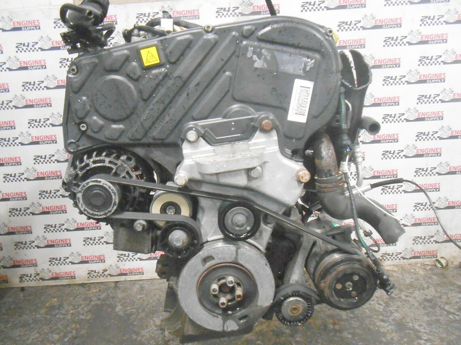

Is this one any use for the project?

Yes it looks like it, if it is a 1.9 cdti 120 bhp fiat engine than it is the same.

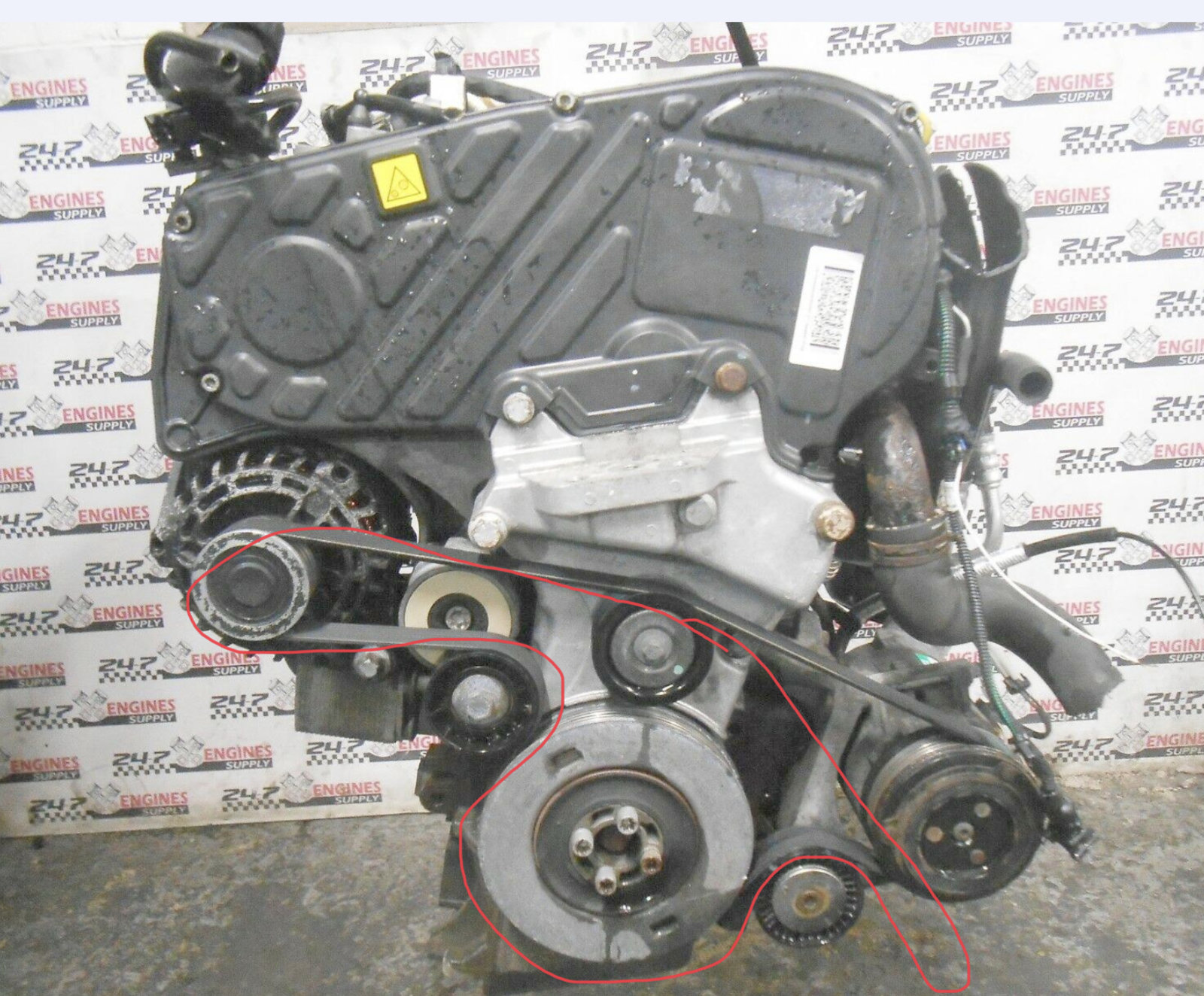

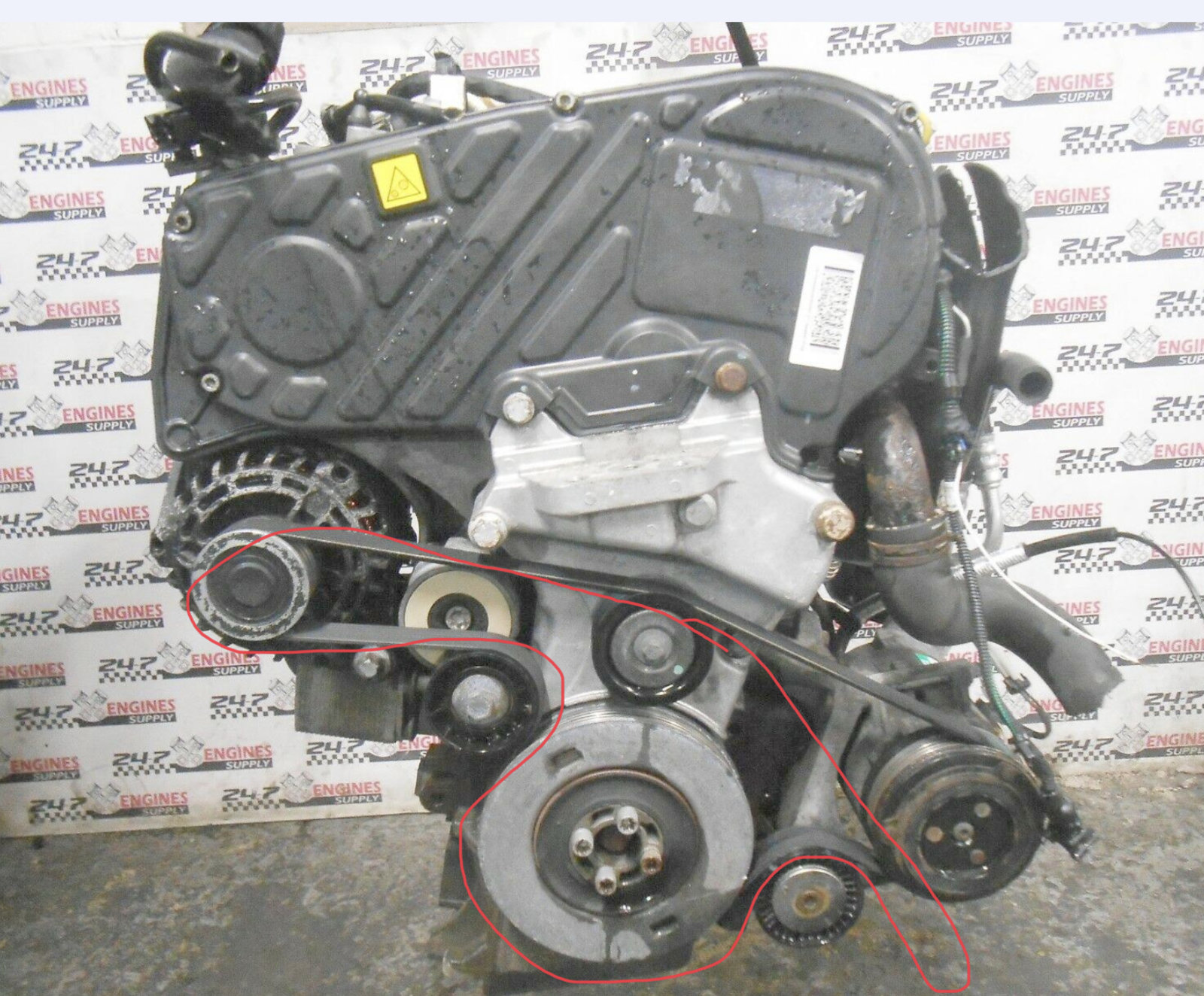

From underneath, I’d try looping the belt on in this position, turn the tensioner as far as you can and then try flipping it on the a/c pulley with one hand. Sometimes if you even get it on halfway so that it holds in position, you can reposition your spanner better and then turn the tensioner to loosen the belt and do the final flip on.

I’d try fitting the belt as per the diagram. Once that’s in position, get a good fit on the pulley bolt with whatever tool you have. The longer the tool, the easier the leverage will be. Pull hard on the pulley bolt and when it can go no more, push the belt on the aircon pulley. If it doesn’t go on fully the first time and it’s only partially on, release the tension on the pulley bolt, fit your tool on it in a better position (as the pulley will be in another position) to get a better pull on it, tighten the pulley, the belt should loosen enough for you to fully push it into position. It’s easier to do than explain and it really isn’t a hard thing to do, it’s just that we’ve been in the trade for 40+ years and experience is everything. Oh, whatever you do, don’t get your fingers or thumb in between the belt and pulley at any time - if that spanner slips off the bolt at the wrong time, it’ll do more than sting a little!

When you say fit the belt per diagram, you drew the red around the pulleys on the picture I can't figure out from 1 - 6 what order you would go in. Would you leave the tensioner alone until tackling the last pulley ?

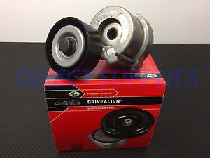

the photo of the tensioner below I think is the same as on my car, is that hole in the top for locking tensioner in ? on youtube tutorial it shows 2 holes to lock it in with also i cant seem to line it up
