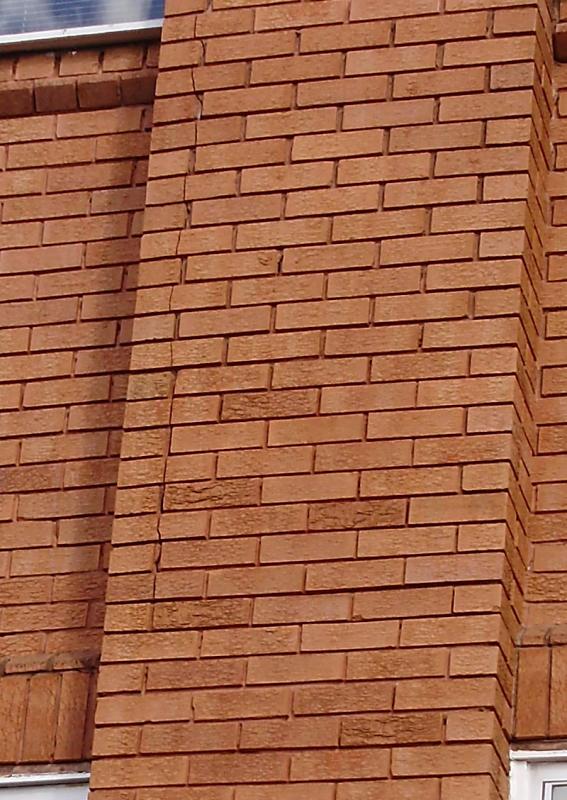

Vertical cracks on external brick wall

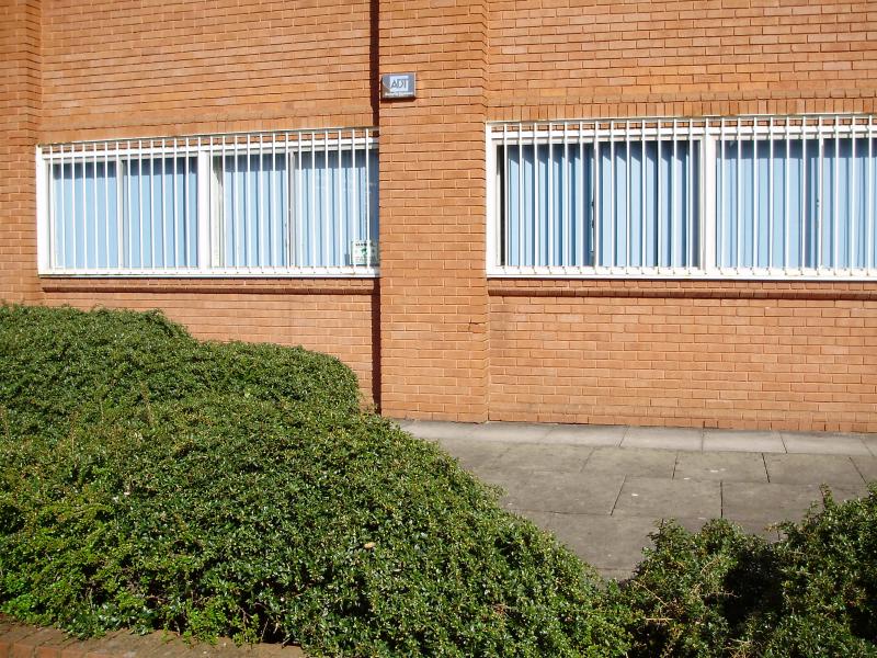

This is an east-facing wall with pilasters at about 13ft centres and no expansion joint. Crack caused by long-term irreversible expansion of brickwork, independent of the day-to-day variations caused by temperature changes.

The building in the pics is (or was) a 3-storey commercial block just round the corner from me. Built mid-70s; the cracks didn't appear until a few (3, maybe 4 years) after it was built. This makes me think it was long-term expansion rather than just thermal movement.
I think the 'pilasters' were 13/14 ft centres, and they had very short returns, which is the classic case where the expansion causes rotation and fracturing of the brickwork. The long-term shrinkage of the concrete frame will not have helped matters.
I wouldn't deny that thermal movement can cause problems, and these are likely to be compounded by the ratchet-effect. There is also the long-term shrinkage of the mortar to consider, so all these forces acting simultaneously produce a complicated picture.
(The block was recently converted to flats, and the brick skin completely removed and re-built [with expansion joints this time!]).

So what are we now talking about here? The OP's problem or the random office block?
In the OP's case the panel has contracted, shrunk. This has caused the crack at the return where the corner has held fast and is a stress point. So the bricks snap close to that. The other stress point, below an opening has resulted in a crack there too
By the look of it, the bricks are a soft clay and the [very grey] mortar is too strong. That is the overriding cause.
Non of this 0.00002 mm per brick nonsense. That is a typical domestic elevation, the movement of large panels does not apply to this. Its a straightforward case of soft bricks and strong mortar. Expansion has not caused the crack, just contraction ... hence the gap
Don't look for scientific explanations where a simple one will do.
With the random office block that crack has a different cause - expansion of one panel has pushed the return, caused it to pivot and so cracked the pier on the return face. It is incorrect to describe this crack as being "caused by expansion" as the cause and effect are distinct, and in different parts of the structure. And that is not just semantics either

First of all, thank you very much for the interest and for the lively discussion! However, I must say that I am really confused now :)
It seems to me that ^woody^ is convinced it is not serious, but all the others seem to have some doubts. Would any other type of photo help? I can call the estate agent, book another viewing, and take more pictures.
If you were buying the house, what would you do? Would you worry and get a structural engineer? Or would you monitor the cracks after you bought it?
Many thanks,
John
Like most posters, my belief was that it is not serious; the debate (or was it discord!?) was more on the lines of what has caused the cracking.
