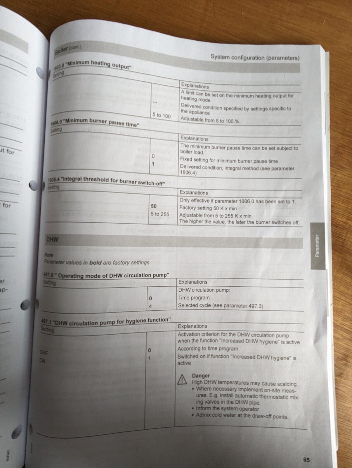

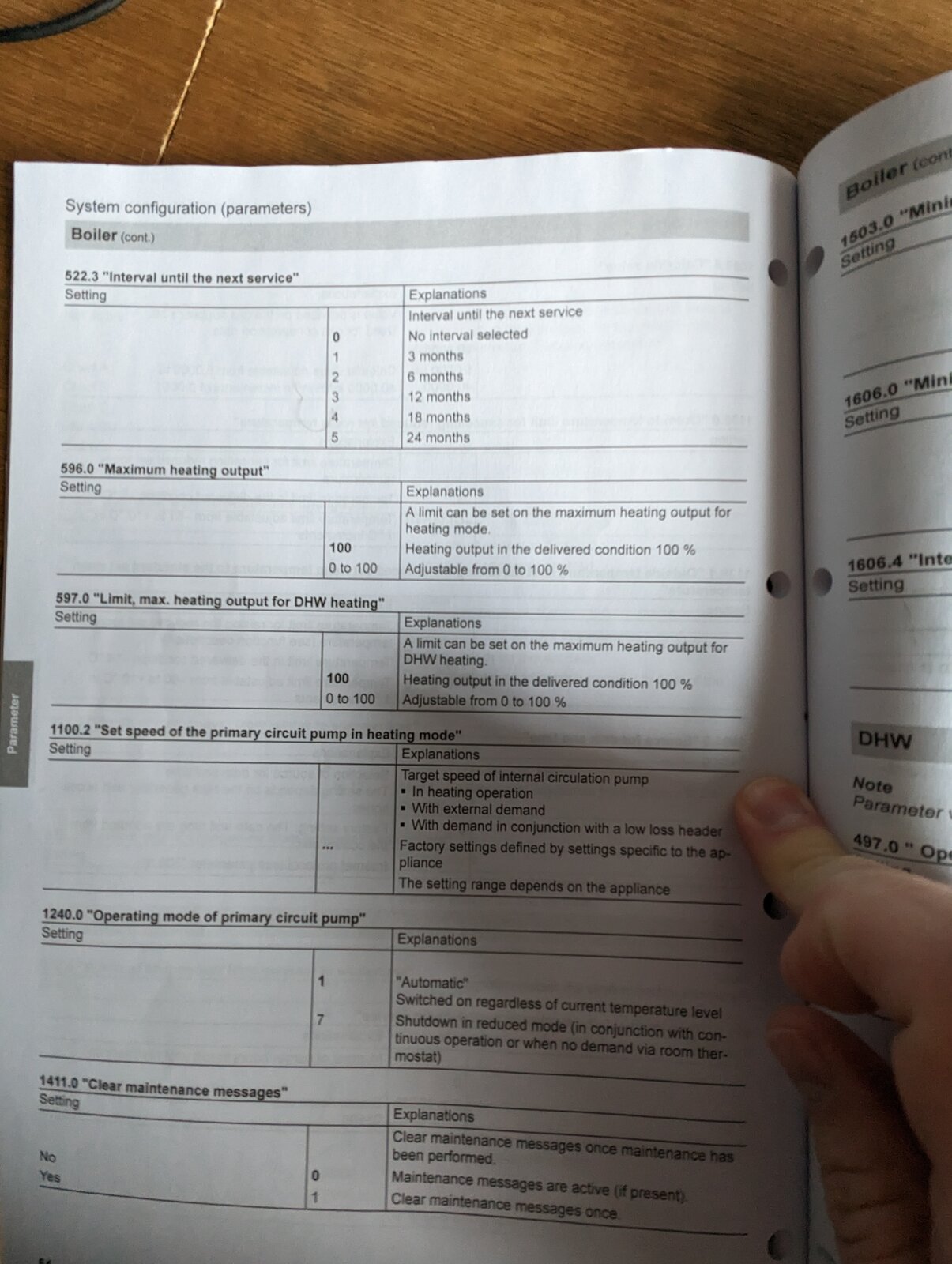

Viessmann vitodens 200 low modulation low run time high return temp
This is what the book says

So, 1.56kwh burned in 11 minutes = boiler putput of 8.5kw, or 26.6% output (modulation), is this correct?
But you have range rated it to 5% which means its output should only be ~ 1.7kw? So why is it outputting 8.5kw?. Did you take the meter readings?
The readings are from my smart meter I could go sit out side and wit for it to burn but will do that when it's not raining and windy ;)
So major update it now works! Error by the engineer when installing the system.
so ive gone from 8 minutes burns to so far a max of 80 minutes! flow temps are also varying more and not overheating and single figure modulation! (but the rate has been varying unlike before) also the pump now turns off at times!
Why is it still cycling a little, assuming demand is still there, demand must be less than than ~ 2kw and if so the flowtemp would have to exceed the setpoint by 5C to trip the burner.
Yep more so the longer burn time as it evens the heat out just wish it was right for the last 2 months ;)
