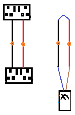

I have been out to look at a problem in a commercial property with time limited access due to the nature of the site.

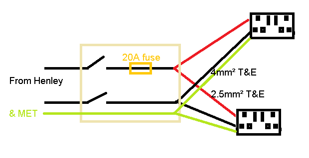

Very simple circuit: single 30A Wylex fused switch containing yellow 20A fuse feeding:
A DSSO in adjacent building with 4mm² T&E guess 15m.
A DSSO in adjacent room with 2.5mm² T&E guess 4m.
While decorating the room the steam wallpaper stripper didn't work but a LED table light does (no surprise).
Extension lead from same circuit from the other building runs the steamer.
My initial suspicion being the socket or plug, tried with their kettle (most common load in other building) and confirm report so fitted a different socket - no change.
Access to fusebox is difficult due to security and a long treck round the building and grounds (300-400m) but can get fusebox switched on/off with ease via phone call.
Switched off I can see open circuit between L & N & E (3 tests) at both sockets, shorting L & N at either socket shows a short circuit at the other. but this is only using a multimeter.
A colleague has been in tonight and confirms symptoms, even swapped sockets over. Couldn't get access to fusebox and repeated tests between sockets using a KEW MFT: L-N loop and L or N - E loop. He didn't send the results other than 'spot on' (second image)
I think this is all it is:
Now waiting for a time for two of us to go in.
Any ideas?

(second image)
I don't really understand that image - it appears to be showing L & N (of a live circuit?) connected together!

I only had a multimeter with me and measured loop resistance socket to socket, as diagram 2. my colleague has done the same test with a KEW, he may very well have done a loop impedance test.
Has someone measured the voltage at this socket when a largish load is connected?
Yes with the kettle plugged in my multimeter shows it dropping to virtually zero.
with the fusebox switched off we have both measured the loop resistance socket to socket by placing a short at one position.
My multimeter showed something like 0-½Ω loop resistance

Hence the reason for my post. I only had a multimeter with me and measured loop resistance socket to socket, as diagram 2. my colleague has done the same test with a KEW, he may very well have done a loop impedance test. Yes with the kettle plugged in my multimeter shows it dropping to virtually zero.
I still don't really understand what is going on in your second diagram.
However, what you appear to be describing sounds crazy (which I imagine is what you also think). IF a ('live') measurement of L-N loop impedance shows the expected 'low' reading at the affected socket, then it makes no sense that the voltage at that socket drops to near zero when a load was connected - Mr Ohm could not understand that!
The only 'logical' conclusion one could draw from that is presumably that when you plug in the load that somehow introduces a high resistance (upstream of wherever you are measuring the near-zero voltage) that doesn't happen when you plug in your loop impedance meter - and I can't thing how that could happen!

Sadly not, just as the sketch straight off a Henley block and Wylex switched fuse... or is it a fused switch. Either way one socket works and the other doesn't.
With power switched off effectively all there is two sockets connected together so I've done R1+R2 test end to end.
I haven't done a loop impedance test, only R1+R2 (between the 2 sockets with the power off) with a multimeter. My colleague may have done a loop impedance test but all he's actually stated is:

With power switched off effectively all there is two sockets connected together so I've done R1+R2 test end to end. .... I haven't done a loop impedance test, only R1+R2 (between the 2 sockets with the power off) with a multimeter.
Oh, I see - I obviously misunderstood what you meant by "L-N loop"
My colleague may have done a loop impedance test ....
That (which I thought was what had been done) is surely what was needed and, in a second message, you go on to say ...
Reply from colleague: "didnt do loop impedance as PFC was only 2A in the hut its 900A"
Which makes one 'wonder' about your colleague :) He says he "didn't do loop impedance" yet he quotes the PFCs (which indicate that he has done loop impedance measurement) !! I obviously don't know what the voltage actually was, but if one assumes 230V, then a PFC of 2A translates to a loop impedance of 115Ω and a PFC of 900A translates to a loop impedance of about 0.26Ω.
So there is no 'crazy anomaly' as I had thought and, in fact, you/he have essentially localised the problem. Since both sockets are fed from the same switch fuse, if the loop impedance is 115Ω at one socket and 0.26Ω at the other, then this obviously means that there is something very high resistance going on in either the cable supplying the first socket or the connections to one or both ends of it.
The next step is surely to measure the end-to-end resistance (separately for L and N) of that cable (your multimeter should be more than adequate). Given that, as I understand correctly, that cable is only 4m in length, that shouldn't be too difficult.
Kind Regards, John

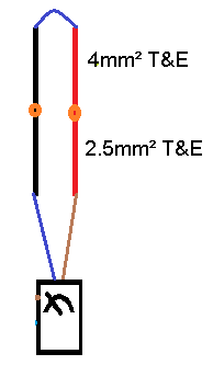

If (per your colleague's PFCs) the loop impedances is about 115Ω at the affected socket (but 0.26Ω at the OK one),there is clearly a high resistance (nearly 115Ω) somewhere between the downstream end of the cable and the fuse. That resistance does not necessarily have to be in the cable itself - it could be in its connection to the switch-fuse.
I agree with all of that...
Except that unless I have got it wrong, ignoring the Wylex which is effectively a junction box (shown as orange circles) with the power turned off with all of the 2.5mm² & 4mm² simply connecting the 2 sockets together
and testing like this
with a short at one socket and meter at the other must, by definition, find that high resistance? That's the test I've done, in both directions.
