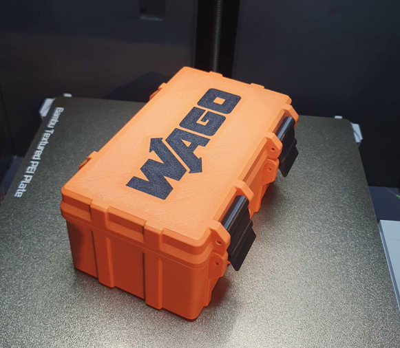

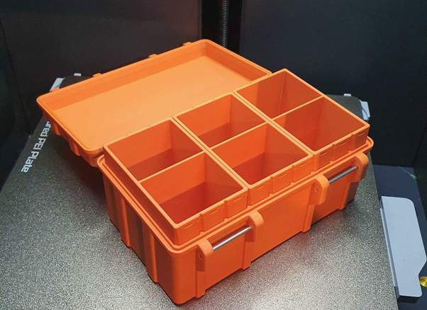

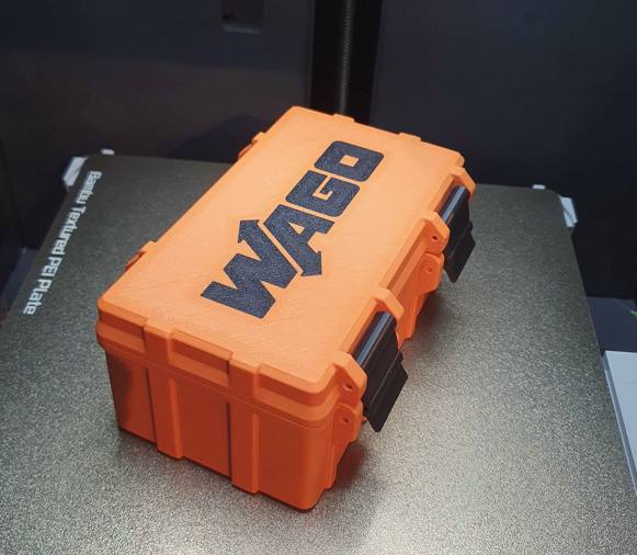

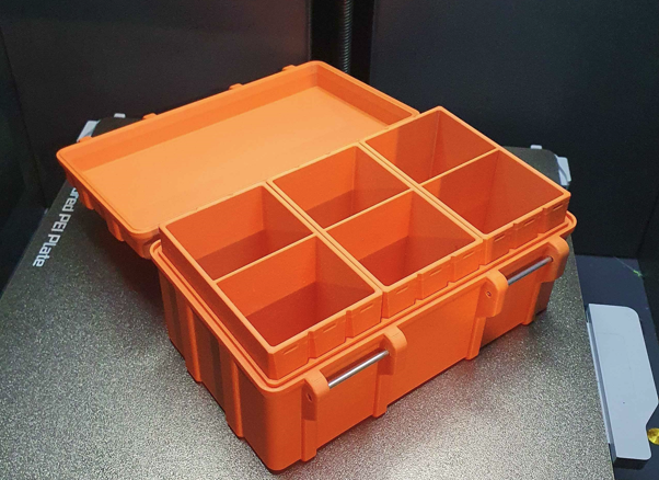

Either way, I now have a nice little collection so I made myself a box to put them in.
One of the lads at work who has a large collection is going to give me a couple of boxes of Wago's so he too can have a box like this :)
View attachment 376237View attachment 376238
if that is 3d printed, start selling them quick as it's brilliant
