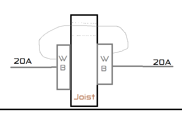

So I put a nail right through a joist that had cables in, puncturing one cable running through the middle of the joist.
The cable is too tight either side to repair to a single box, so my thought was use a junction box, extend say one metre through the joist, then another junction box on the other end to connect back into the other cable
WAGO comes to mind, with their enclosure box
So, the setup would be, Wagobox, 1 metre length through joist, to another wago box. Can you extend a mains cable with a 32A 222wago? or are two wagos in line a no-no.
Two wago joins is fine, would be better to replace the cable but if that's not an option, what you propose is fine.

Hi All, and thanks for battling it out, I'm getting similar results all over the internet and no straight answers.
I contacted Wago themselves, they say
"The 222 series is suitable for 2.5mm² twin and earth, if that is what you are repairing.
If the junction box is to be inaccessible when finished, you must follow the instructions for the maintenance free applications (see attached leaflet)."
For clarification. My circuit is also 20A at the trip switch. I intend to use the wago connectors and their box. Be careful online, their are LOADS of Chinese copies, whilst may be ok, wont have the BS stamps.
here you go.
Heck my local builder just said use a 32a junction box and be done with it, but I'm glad to follow protocol here as it will be semi inaccessible (under a hatch under a carpet)
