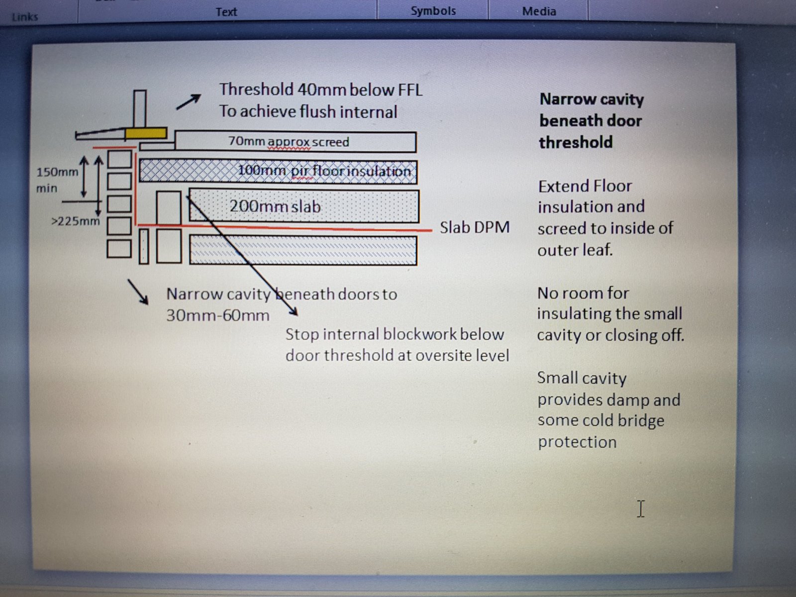

I get our builder to reduce the cavity width down to 30-50mm at door openings and stop the inner leaf at oversite level, then run the floor insulation and screed to the inner face of brickwork.

Ok, so that is a variation of what I read in an older Diynot post, so in your suggestion you push the cavity closer to mimimise the unsupported insulation overhang in the cavity? Still relies on fixings for the door track not falling on the 30mm to 50mm cavity width, I suppose? The floor insulation won't bow down in 50mm unsupported cavity span?

I prefer to keep a cavity under the doors even if its just say 30mm or so -that way any water ingress cant get inside to the screed layer.

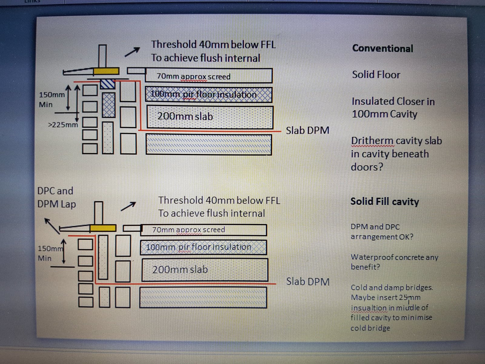

Ok. So I tried to sketch out the arrangements as I understand them and from helpful suggestions.
The conventional arrangement with the cavity closer both my builder and window installer don't think is viable at all, so just a starting reference for me to understand versus other options.
Have I got these generally correct especially positioning of DPM and DPC?
The solid fill, I could insert a slither of say 25mm insulation between the solid fill and use damp proof concrete. Would either be of any benefit?
I haven't drawn up the bricks on end option, as I'm not sure I understand properly or see the benefit. The cavity would still be 100mm. So the gap for trying to mount the base of the doors in potentially unsupported area above the cavity still exists but it has brought the inner course in 35mm. Does that help much. Sorry, I may be being a little slow with that...
My layout options attached.

Thanks for replies. So, the door track is about 180mm excl. a minimalsit 10mm cill overhang on the external. So what we have decided on today, which hopefully solves, is lay a second course of bricks against the outer leaf on their edges. So 100mm outer, 65mm+10mm mortar for bricks on edge beneath doors.
So total solid support for door track and all fixings is 175mm deep from outer leaf outside face . Then a 25mm celotex layer behind to fill the remaining 25mm of the 100mm cavity below. The inner blockwork is to stop at below slab level. so the 100mm floor insulation and part depth of the screen butt up to the thermal break upstand. Slab is under insulation due to UFH.
DPC covering thickness of 175mm outer combined leaf. DPM brought up inside (room internal side) of insualtion.
