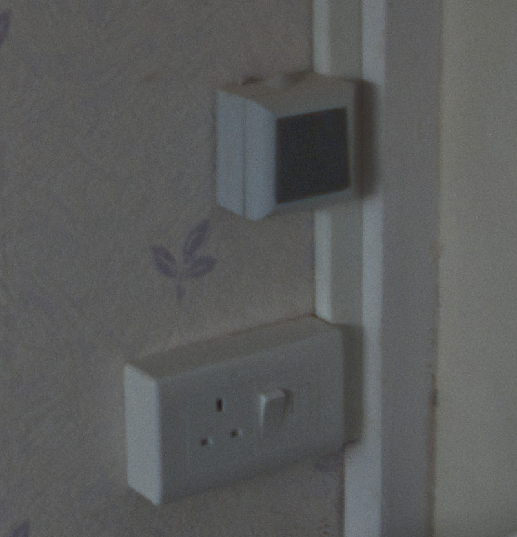

Screwfix LAP range do a grid system where a fuse holder, switch, socket, etc can be clicked into place with a single or double socket size back plate, so yes can be done, this IMGP7387.jpg socket at bottom had 13 amp socket, switch and fuse as an example.
