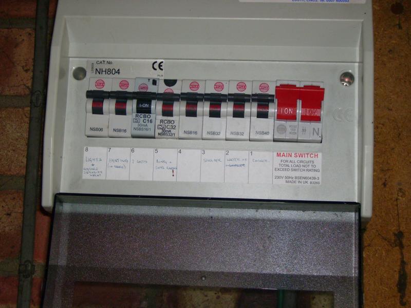

Are you certain that the device that is tripping is an MCB, not an RCD?
Can you post a piccy?
You do not have an RCD so tripping fault must be on the circuit that trips.

Your socket circuits are both on RCBOs (RCDs).
These monitor the circuit for earth leakage and only need a tiny amount of current to leak in order to trip them - approx 0.025 amps to 0.03 amps)
I'll bet good money that you have a neutral - earth fault on one of these circuits.
Without going into details, neutral/earth faults are load-dependant and so tripping of the RCBO can appear to be intermittent.
In some circumstances, the tripping can be caused by loads on other circuits - even with nothing plugged in on your socket circuit.
You need to get a spark who knows how to test properly - get him to do full ring-final continuity tests and IR test....L-N, L-E & N-E.
If he knows what he's doing, he'll find the fault. :)

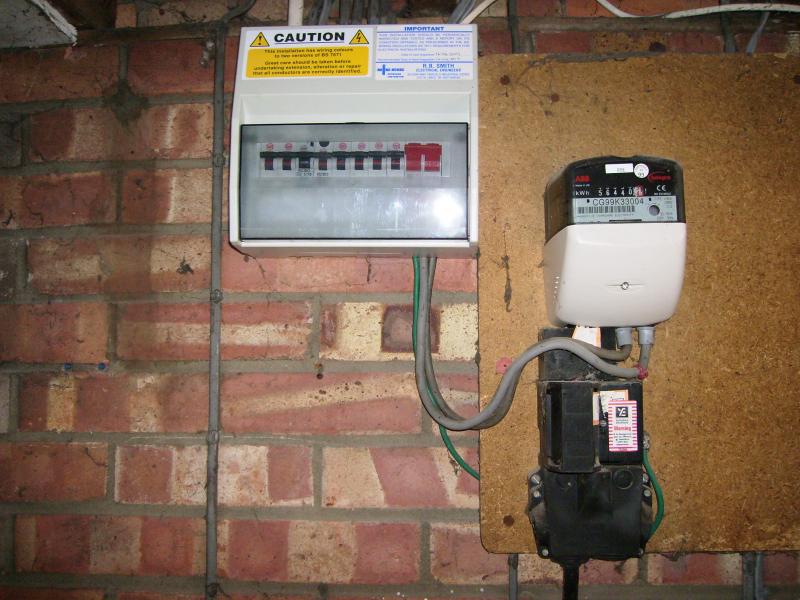

It would help if you told us which item in your CU is tripping!
Is it the one marked "RCBO C32"?
If so then Electrifying is spot-on. N-E fault somewhere...
Yes, correct it is RCBO C32 (circuit with most of our wall sockets on it).
