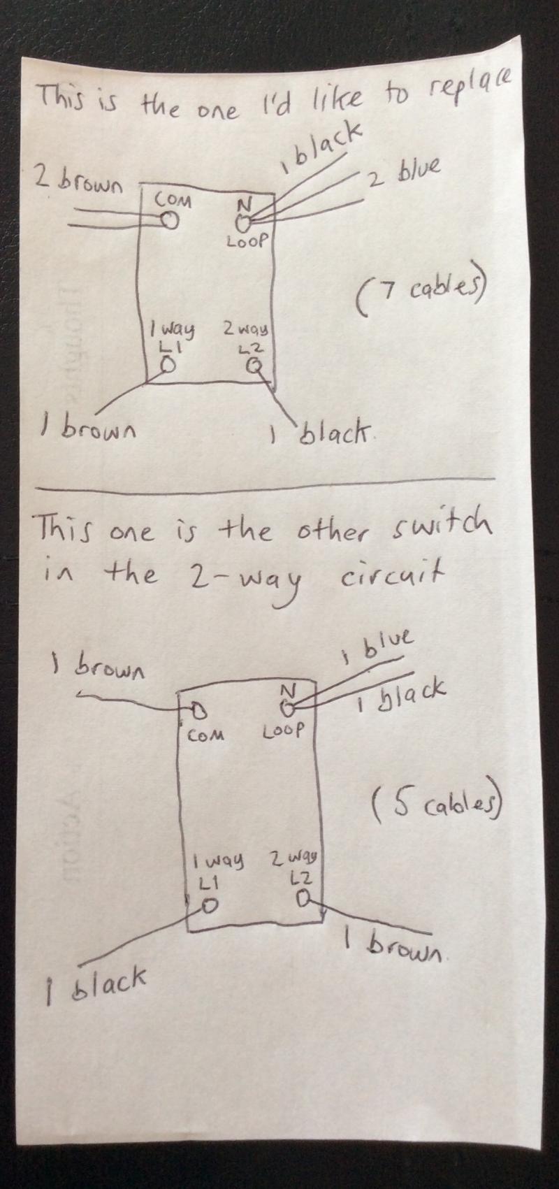

I have a feeling your initial lamp was not allowing the internal battery to charge. Changing to the normal type of lamp has allowed the battery to begin to charge, and the unit to start to function as it should.
I think even some 'pro' sparks would struggle to fit that timer without a little scratching of the head to begin with, as it goes a little against the convention of how standard two way switching is wired, and your wiring (while not too unusual) is a little different still.
