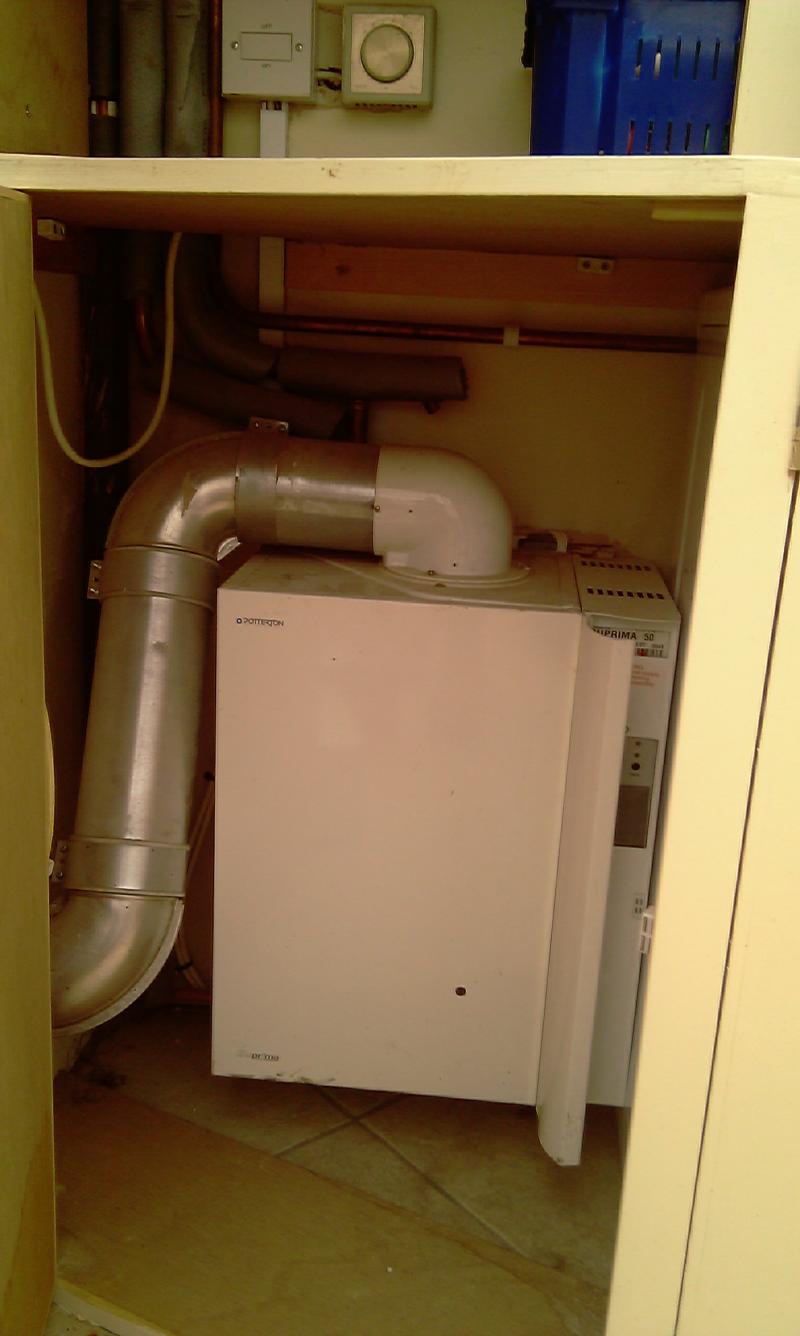

So, Potterton now make tumble driers as well as boilers! :LOL:
I am still trying to work out how many violations there are on that installation.
Yes but the flue isn't one of them. I confess I'd not come across it before so I wrote to Potterton who said it's fine on a non condensing boiler. Don't even have to get a dispensation form the manufacturer.
I've lived a sheltered life.
well if I went to that installation I would also take a photo and then explain why I am not going to work on it, unless they want me to remove it and fit a new boiler. What about side clearances? The PCBs on those go fairly regularly, and to do that you have to get a screwdriver into the right hand side which you can't on that one.
I don't think a self respecting installer (assuming he is registered) would do an install like that would they?
Is there a grille on the terminal and is it covered with undergrowth? Snails crawling into the flue?
Well done for contacting the manufacturer to query it, and posting the reply. Thats why we come here, to learn. Anyay, nice photo and thanks for lightening my day! :D
There is a removable side cheek to the cupboard for access and the job was a really neat install. Grille over terminal, no bushes etc.
I was surprised with Potterton's answer and also queried it with our tech guru who said no, they'd done it when necessary on BG installs but would try to avoid it if possible.

Yes any boiler now would have to be fixed differently as the flue has to slope back to the appliance but of course in a non-condenser it doesn't.
