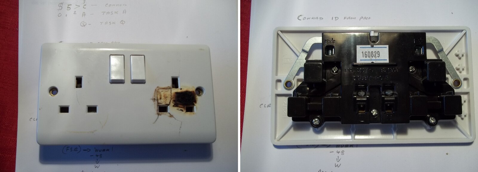

No need to "think it up" it happened a few weeks ago. The plug had to be levered out of the socket.
Fortunately getting the charred plug out of the socket removed the path to Earth and the RCD could be reset.

No need to "think it up" it happened a few weeks ago. The plug had to be levered out of the socket. Fortunately getting the charred plug out of the socket removed the path to Earth and the RCD could be reset.
I must say that I still really don't understand how an N-E fault could possibly result in that and, in any event, why the RCD (which would have operated in milliseconds) did not prevent the degree of thermal damage to which you refer,
Are you sure you've "got things the right away around" and that you're not talking about a situation in which overheating of a plug (due to poor connects/contacts etc.) over a long period of time, with currents not high enough to operate an OPD) eventually caused so much thermal damage as to create a N-E fault, which then immediately tripped the RCD, which then couldn't be reset because the N-E fault persisted? In other words, the N-E fault was the result of the situation, not its cause.
If so, although that's not an impossible scenario, I would think it incredibly rare. Plugs overheating to the extent of being irremovable from the socket are rare enough - so for that to progress to creating a N-E fault must be incredibly rare!
Kind Regards, John
The fuse in the moulded on plug was the source of heat, Load was a 2.3kW heater, ( verified by measuring the resistance of the element ).
Plastic sleeve on Line pin melted and deformed, then when cooled down the altered shape of the sleeve prevented the plug from being removed from socket without the use of brute force.
It was reported that :-
There was a strong smell of burning and the switch on the socket was immediately switched OFF (1) When the switch on the socket was switched back ON the power went OFF (2)
(1) The heater was still working so RCD had not tripped,
(2) 2.3 kW was not an overload so MCB did not trip
The owner wanted to return the heater for a refund so an investigation of the damage inside the plug was not possible.
It is very probable that the inside of the plug continued to smoulder for some time after the switch on the socket was turned OFF and this had continuing smouldering created a path of carbonised material that created an Earth leakage fault.
Resistance testing on the pins on the plug with the switch on the heater switched OFF indicated a path from Neutral pin to Earth pin sufficient to trip a 30 mA RCD
Deposits of "soot" inside the socket would have also created another path to Earth but the resistance of this was not tested before the socket was taken apart
Fair enough - so exactly as I suggested ...
... Are you sure you've "got things the right away around" and that you're not talking about a situation in which overheating of a plug (due to poor connects/contacts etc.) over a long period of time, with currents not high enough to operate an OPD) eventually caused so much thermal damage as to create a N-E fault, which then immediately tripped the RCD, which then couldn't be reset because the N-E fault persisted? In other words, the N-E fault was the result of the situation, not its cause.
... in which case, as I implied, I think that you rather confused things by responding as you did to my ....

... which left me wondering (and asking) how on an earth an N-E fault could result in "the plug overheated and welded it self into the carbonised socket". However, you now admit that the primary fault was not an N-E one but a (I would think extremely unusual) complication/result of a primary fault which was over-heating of a plug due to other reasons - so I now understand what you have been trying totalk about!
