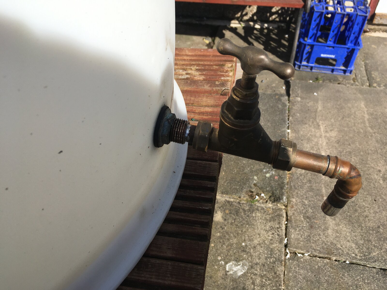

Not with a proper tap on and beats carrying it from a tap back at the house. I think I might have solved fitting the tap - I found a fitting with a flange, a thread, a sealing washer and a nut. Basically, drill a hole, fish the fitting through, with washer, then screw the nut on tight. The thread suits a compression fitting, short stub of 20mm pipe, then a tap.

As it's a gorgeous night, we plodded on, and got a tap installed, successfully, with a revised method. The flange kept turning, trying to tighten the fitting. I eventually solved it, but soldering a short stub of pipe, into the flanged fitting.
[EDIT] Having worked out what the 'flanged fitting was', it was similar to an Essex Flange, except instead of having an hex on the inside, it had a pair of pegs cast into the back of the flange, to prevent it turning.

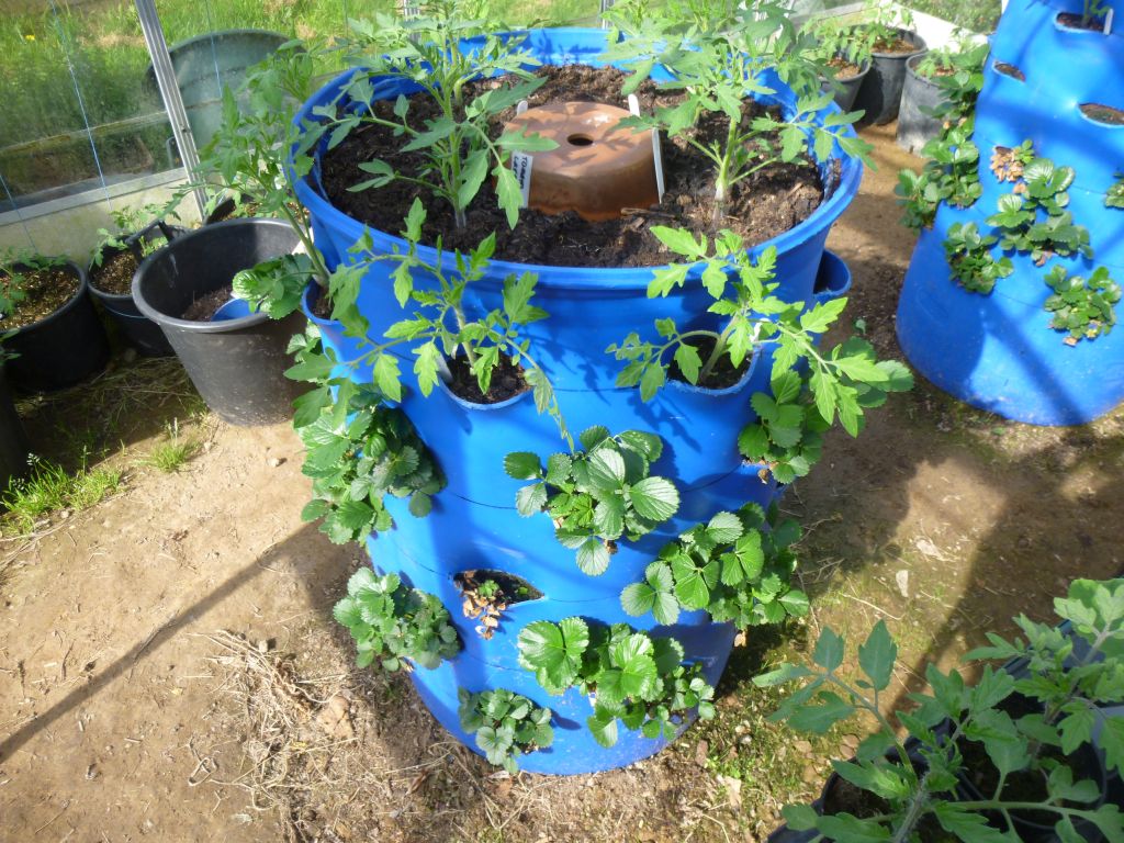

Here's another use for the drums, you make the 'pockets' by cutting a slot, heating it, ramming a glass bottle in

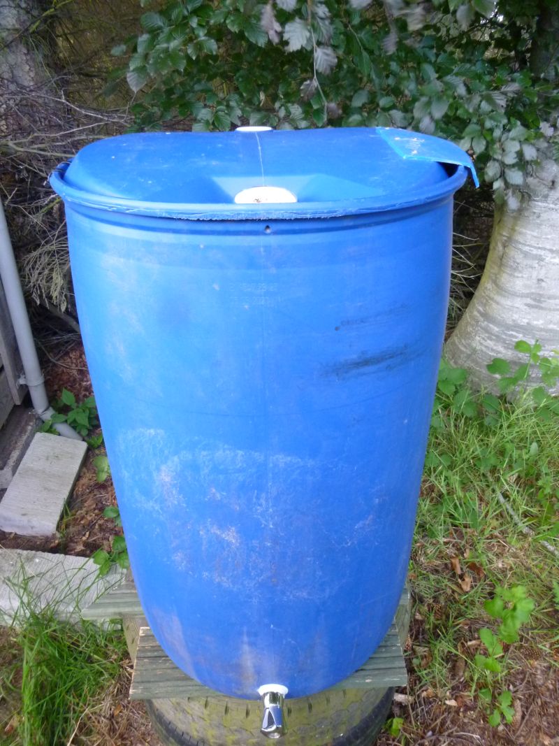

So I took another blue drum out of the stockpile today.

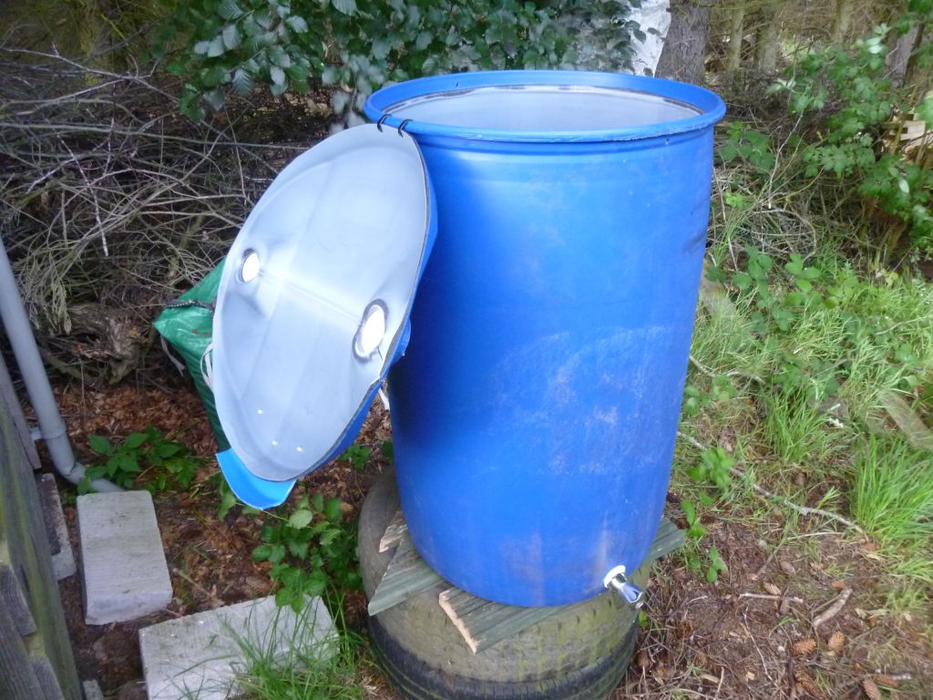

I normally cut the lids off by taking out one of the bungs, and use that as a start point for the jigsaw to go round the rim. File off any rough edges and try and tip as much plastic dust into the bin as you can.
I've got a box of old household taps, I've used a basin tap which is 1/2", fine for this, but for normal rainwater use a 3/4" bath tap is better.
Cut the end of the tap off so the liquid will come straight out.
Drilled a 20mm hole so the tap is a really snug fit, it actually threads on to the drum. A good smear of silicone sealant on either side then do up the nut - not easy on your own!

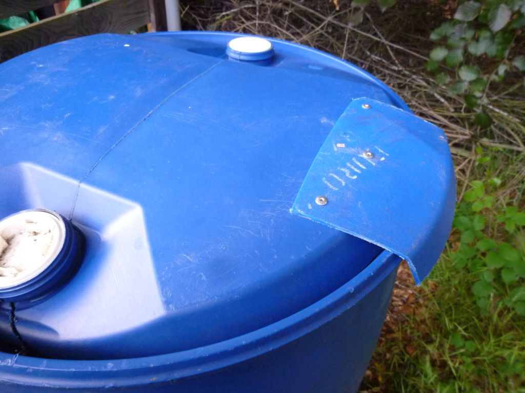

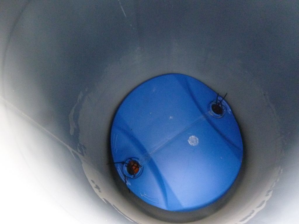

Made a hinged lid using a couple of thick cable ties and a scrap of plastic from the spare top of another drum, riveted on

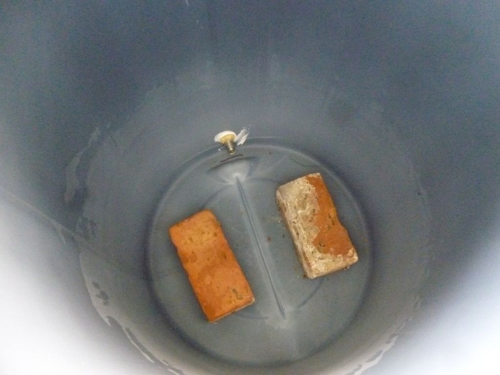

Inside there's 2 bricks and another spare drum top, the idea with that is the liquid can pass round the sides, but it should keep the leaves away from the tap.
It's hidden down the garden so as a stand I just used a couple of old wheels and some scraps of wood.
Not done it before, the idea is you fill it with comfrey (and weigh it down with a stone), maybe the odd splash of water, and the thick black fertiliser will collect in the bottom.

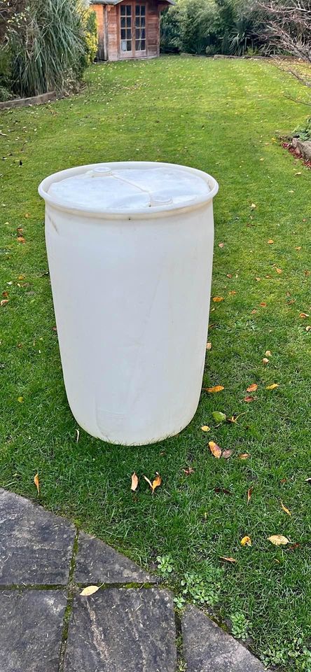

We covered the white plastic 200L drum, with a piece of visqueen(sp?), cut to size, leaving a full height vertical gap, above the tap, so we could keep an eye on the water level.
We were thinking about what to do with old, leaky butt, last night. First thought was to cut it into bits, to fit in the bin - second idea, and the one we settled on, was to cut it 1/3, 1/3, 1/3 to make a couple of planters and dispose of the centre bit. It has a large access hole in the top, with a large cover. The cover will drop into the inside of the upper 1/3, to make a base, to keep the soil in.
