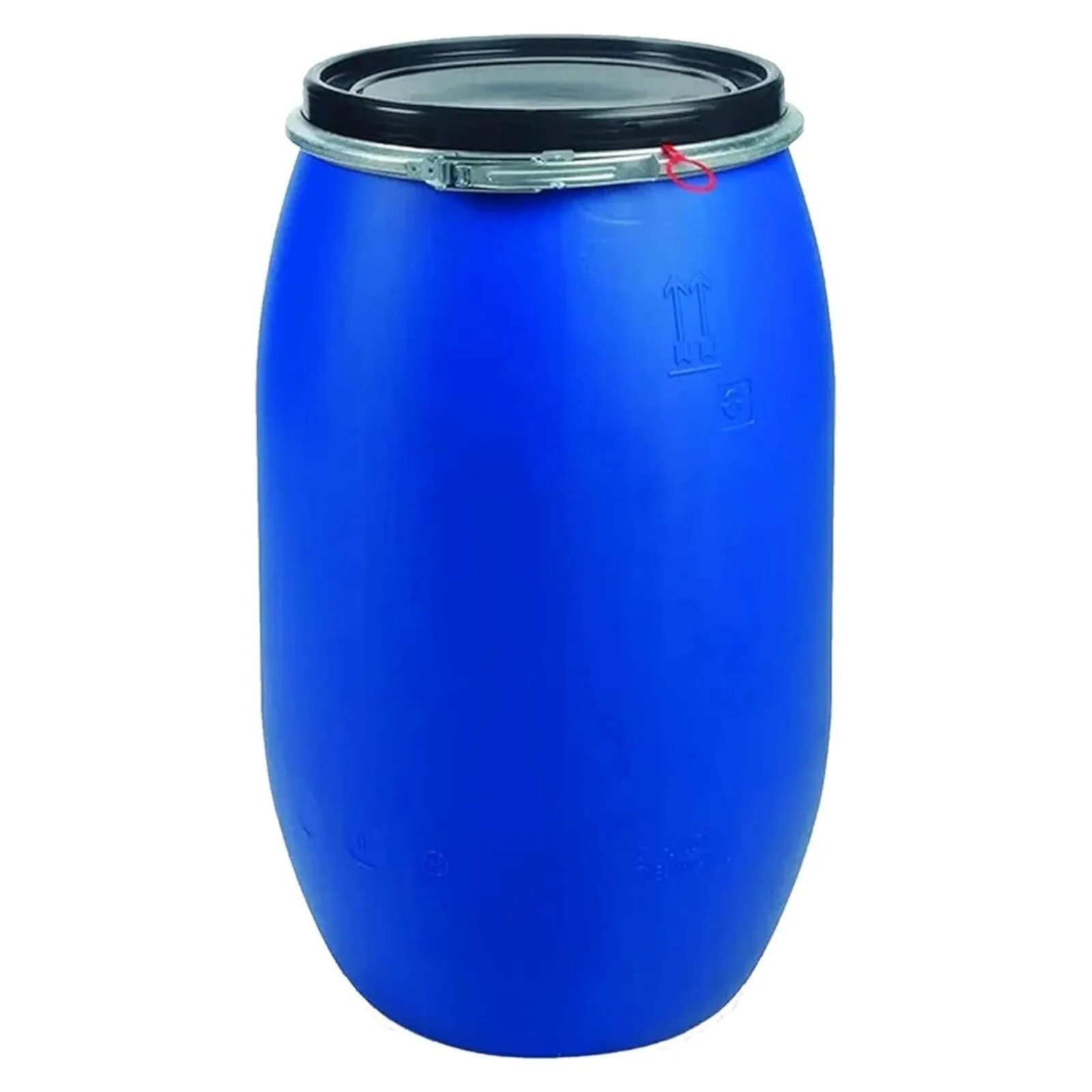

Here's another use for the drums, you make the 'pockets' by cutting a slot, heating it, ramming a glass bottle in
This looks great - what do you heat the plastic with to make it soft enough?
As above, heat gun, each hole needs a lot of heat, a gas blow torch would be faster if you had one.
Cut the slots with a circular saw, or angle grinder if you were really stuck.
Sometimes easier to start with a small prybar before the bottle.
You want bottles with a tapered neck, I don't drink wine so it was glass irn bru bottles for me! The bottles need to be left in until the plastic cools, so the more the merrier, and I used water to aid cooling.
Mine have 40 pockets each, 5 high, 8 per row, evenly spaced. First drum took ages, second one was half the time once I had it sussed.
