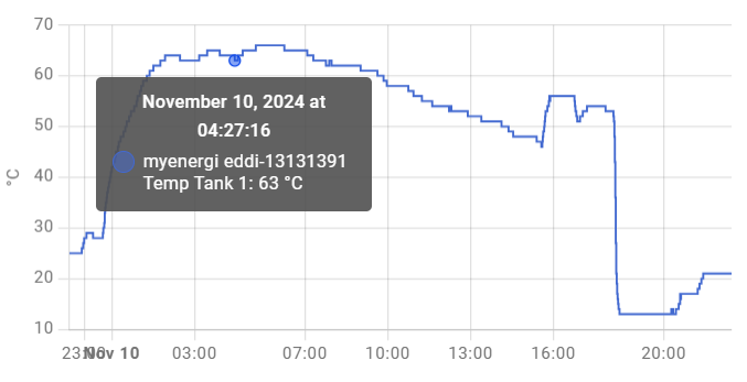

The temperature of the hot water according to the Eddi is

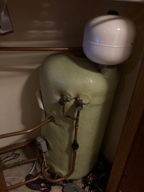

I think yellow is much older than 2000. But you said unvented, which will not be copper, or yellow.
The sensor is a pocket in the tank - not at the immerser- slightly lower- where the box is on the left.
It is showing as lower than the cut off on the thermostat of the immerser but the immerser is cutting out and tripping.
The wood pellet burner is showing as the water being at the tame temperature as that of the Eddi so both are in agreement.

If thermostat in immerser is set at 70 or just below then Wood boiler and Eddi are showing at between 62 and 65 before it trips.
1) That's not unvented. Yellow is very old.
2) the sensor is below the immersion so will read a lower tempersture. The hot water stratifies at the top

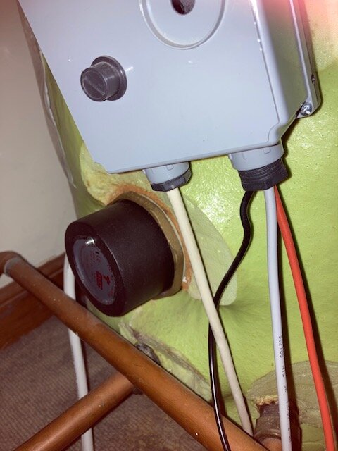

3) please show us a photo of the thermostat in the immersion heater, showing the wiring connections.
Sorry. Never seen one like that before.
Is the arrow pointing at 60? I can't make it out. It does not look very old. I can't see all the wires but presumably the brown or red one goes into the stat.
They are not very accurate, try turning it down by 10, but get a new one, they are not expensive. Poke something down the stat tube to see how long it is. If I interpret the pic correctly, it is horizontal so length should not matter much.

BTW cylinder might be light green which is newer than yellow. Current foam is blue but unvented are usually white, having a secondary metal enclosure.
I think it is light green - didn't know that they had standardised an aging process.

Just to be sure, if you havn,t all ready done so, switch off the power to the immersion, with the m.meter to ohms, probe across the two stat terminals, turn the stat up and down, when it clicks when you turn it down, check for open circuit, turn it up, check for continuity when it clicks. Should read 0ohms or 0.2/0.3, if this checks out then a faulty hi limit since these dont operate until ~ 85C.
Turning from
70 is 0 ohm
Click heading colder is: there is no click
25 is reading 122.1kohm
Heading hotter to just before click is out of range then 0, 0.1,0.2,0.3 at click
