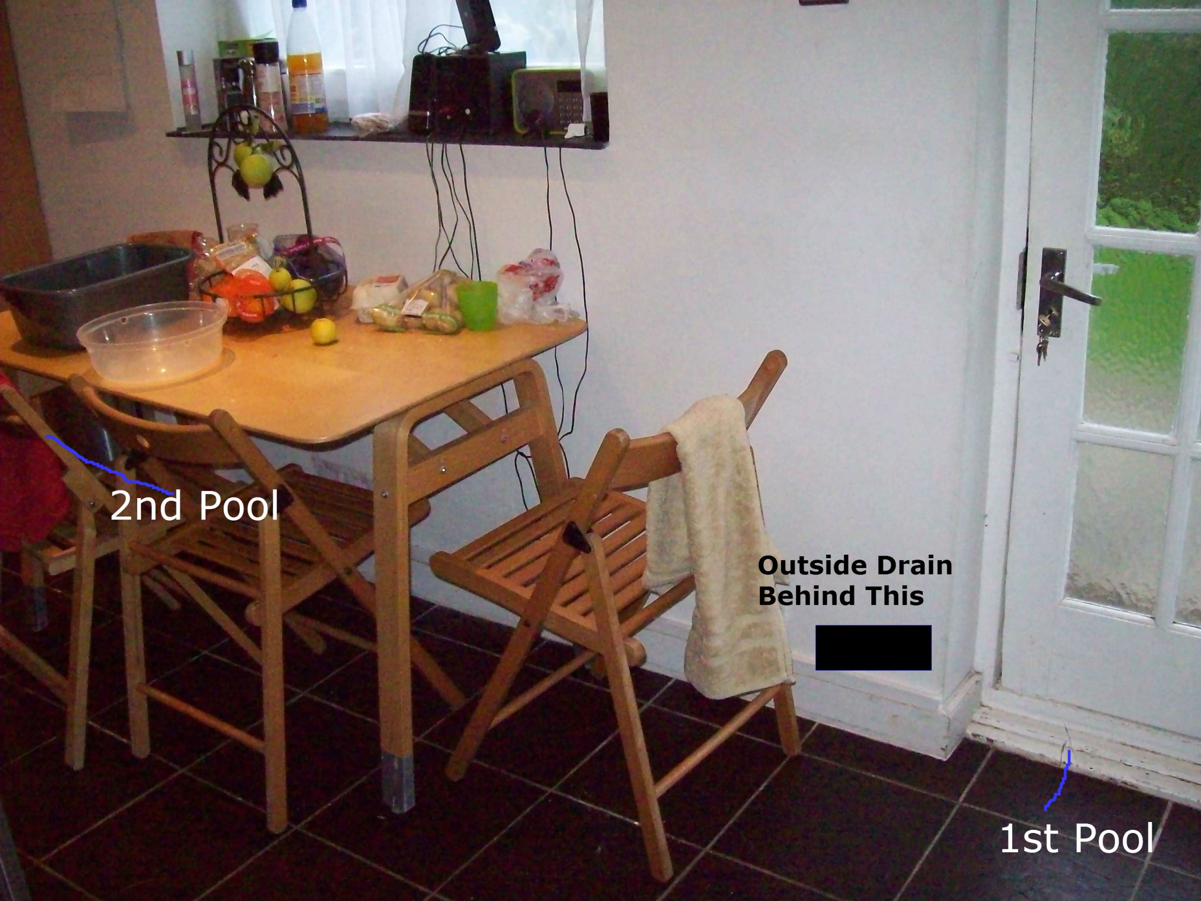

We noticed 2 separate pools of water on the kitchen floor over past few days. The 1st pool is coming from near the kitchen door on the right side of the wall. The 2nd pool is about two meters away, coming from left side of the same wall.
At first thought the drain outside the kitchen door must be blocked and must have caused pools and damp socket by slowly overflowing and running along the wall in both directions. I tried to unblock the drain but the pools still showed up the next time I turned the tap on for a few minutes. Had a closer look and the water doesn't seem to be overflowing from the exterior drain. 1st pool seems to be coming from just at the bottom of the door, through the wooden frame/door step and the 2nd pool seems to be seeping straight through the bottom edge of the skirting?
A photograph of the affected area would be useful - from a distance showing the complete wall

Small Kitchen so the angle was a little difficult..

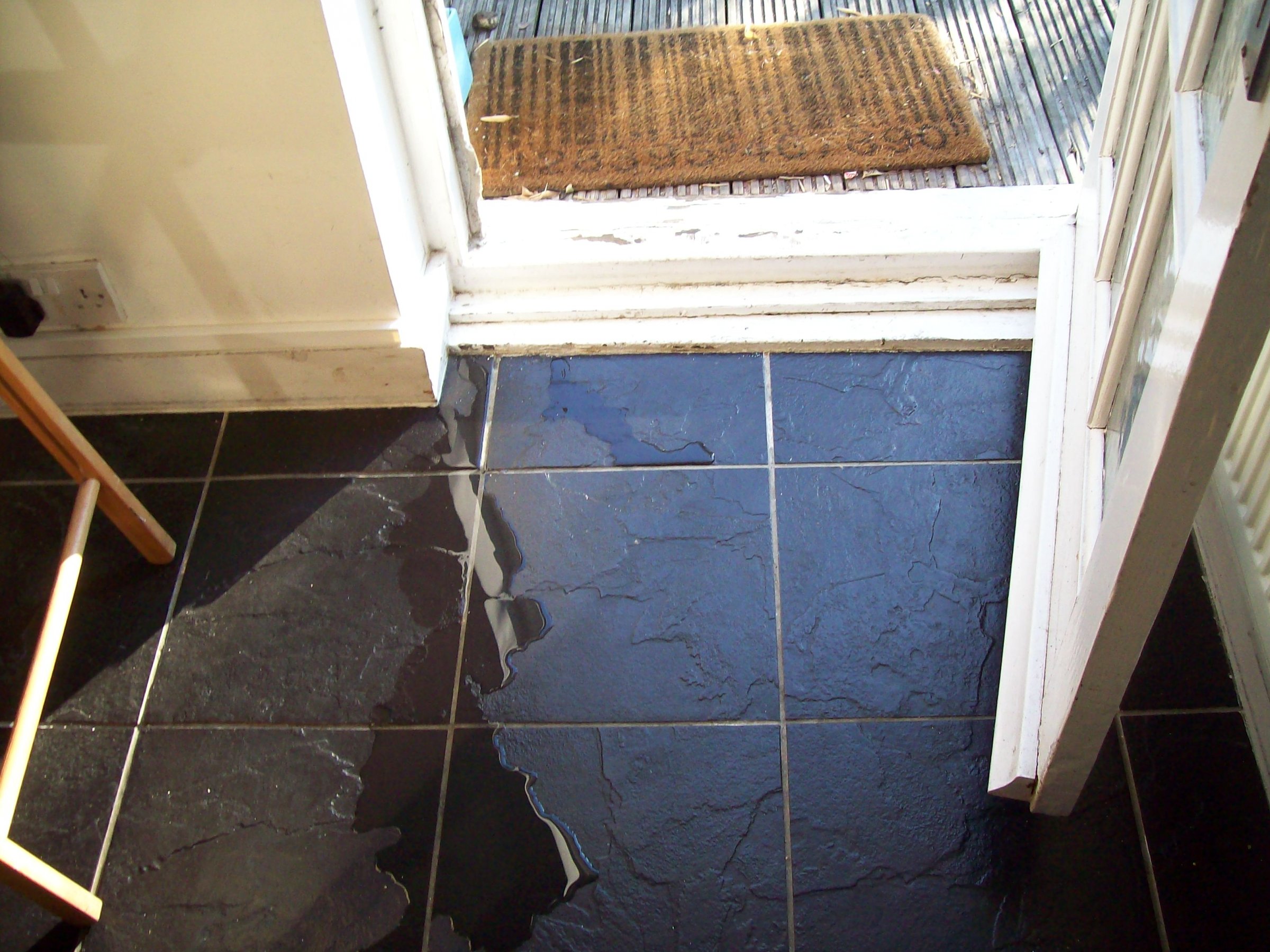

1st pool near door

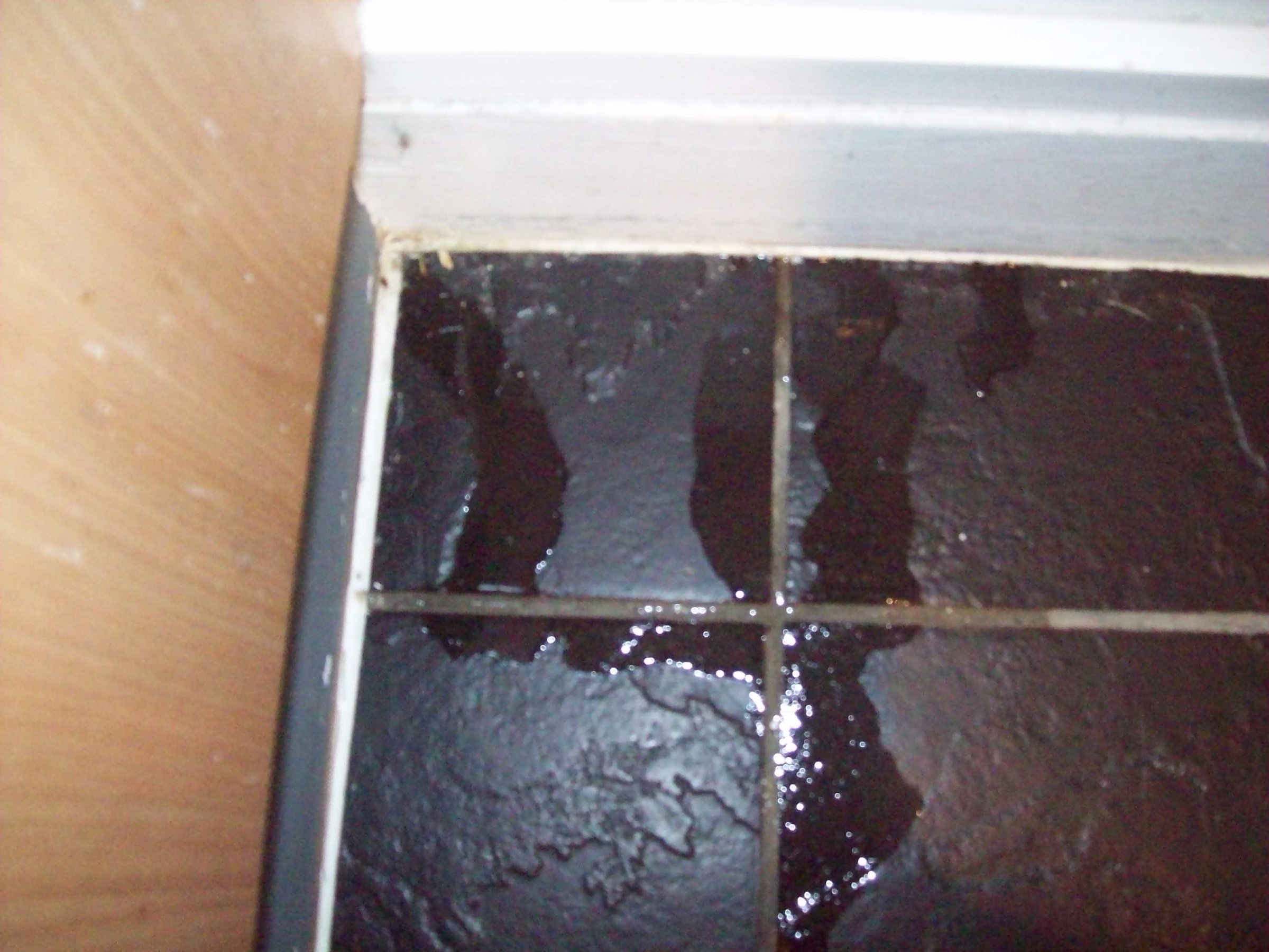

2nd pool near fusebox/cupboard

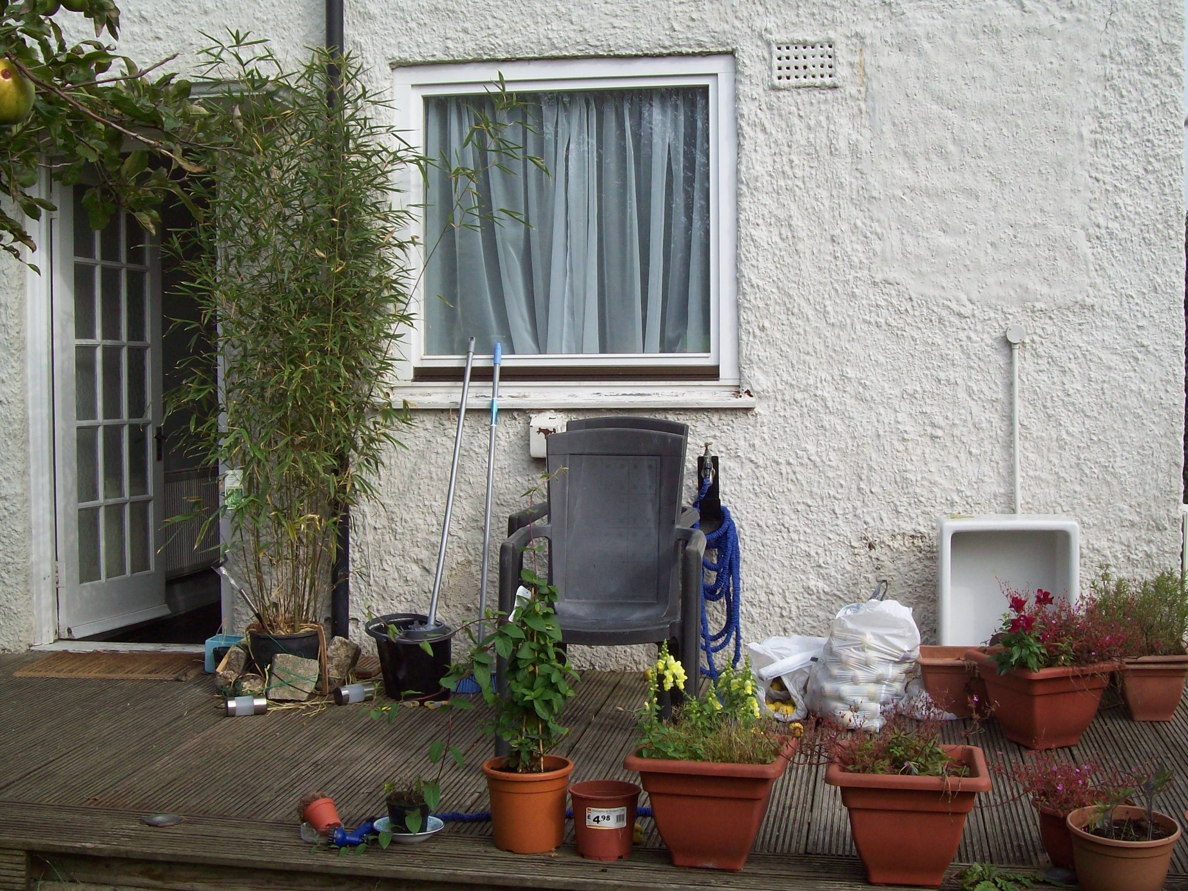

Exterior view {1st pool is on the left by the door, 2nd pool is on the right side of the window, coming from the skirting board. The drain is right beside the door behind the bamboo plant.}
As the water appears so quickly and in such volume, I can only assume that one of the pipe bends has come adrift, for reasons unknown......presumably the pipe is behind the skirting, then turns and exits through the wall?

I'm not sure of the rooting of the pipework but was hoping that it's behind the skirting instead of underneath the tiling. The water does exit directly into the drain from the wall but can't quite see the pipe because of the roof drain blocking the way. I'm guessing you're right about the pipework but a strange thing is that the 1st pool of water is actually forming past the drain, coming from underneath the door whereas I would have thought the pipe wouldn't extend that far? That's what made me initially think that maybe the pipe is under the tiling instead of behind the skirting or am I way off base?
That volume of water in the photo is an example of the pooling after I left the tap on for 5 minutes straight. When the tap is used sparingly it doesn't seem to pool the water in the same way although there are still some traces of water showing up.
The leak is above the tiles.....it wouldn't pool the way it is otherwise.
Can you measure where the drain exits the wall and compare it with your floor, just to confirm?
The decking is in the way for us to see here.

The fact that the water is coming from where the skirting meets the tile floor has to indicate a fault with the pipe. How far away is the sink?

A pic of the outside around the deck area could be useful, just so we can see the drain exiting the wall.
