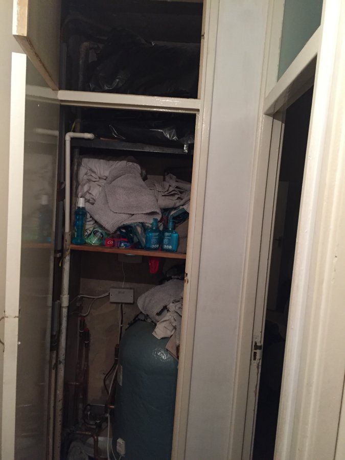

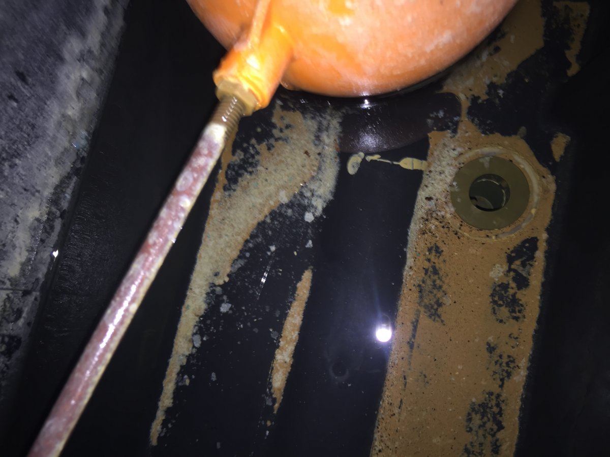

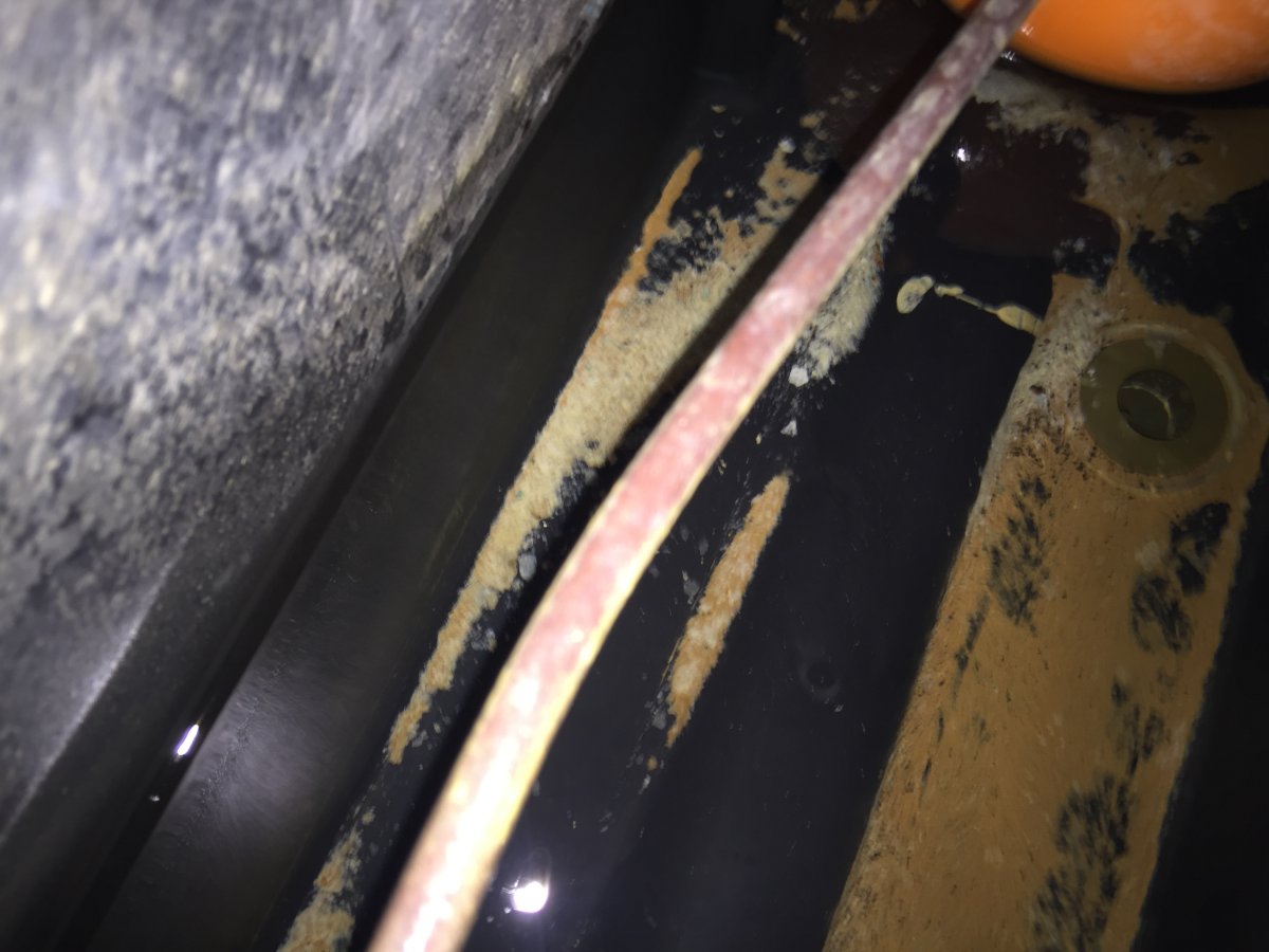

My water tank is not filling up and therefore no hot water which means no bath. This is only upstairs but in kitchen downstairs is fine.
Attached are pictures of the tank. It's old building, pressure is long w anyway. There is shower with a pump installed to increase the pressure. We can have only one or two baths a day these days and there are 5 of us.
To be honest this had been a constant issue for us in last 6 months. The ability of the tank to replenish is very poor.
Anyone has any ideas and can offer advice is much appreciated,
Thanks.
Regards
Sal.

Check that the jet in the ballvalve isn't clogged up
Sorry where is the jet in the ballvalve.
Problem is that water tank container is in very tight space as you can see from the picture. Will I have to take the container out first, install a new ball valve and then put back in place.
Not sure that's a good idea
The ballvalve is the brass fitting connected to the orange float in your 2nd picture
If space/access is tight then (as HERTS suggested) replace the complete unit

You need a professional in I think so first understand your system and then fix it as you have a couple of issues that need sorted. The cold water cistern needs investigated to find out if the ball valve is the issue or the cold mains feed to the cistern is where the issue lies. Then the pump and it's supply needs looked at as that white plastic supply pipe looks a bit dodgy and the pump may need a bit or work.

Don't over analyze this with what works and what marginally works. That tank needs to be full of water. It replenishes itself automatically via the valve operated by the orange float. Get that resolved and everything else should be fine.
