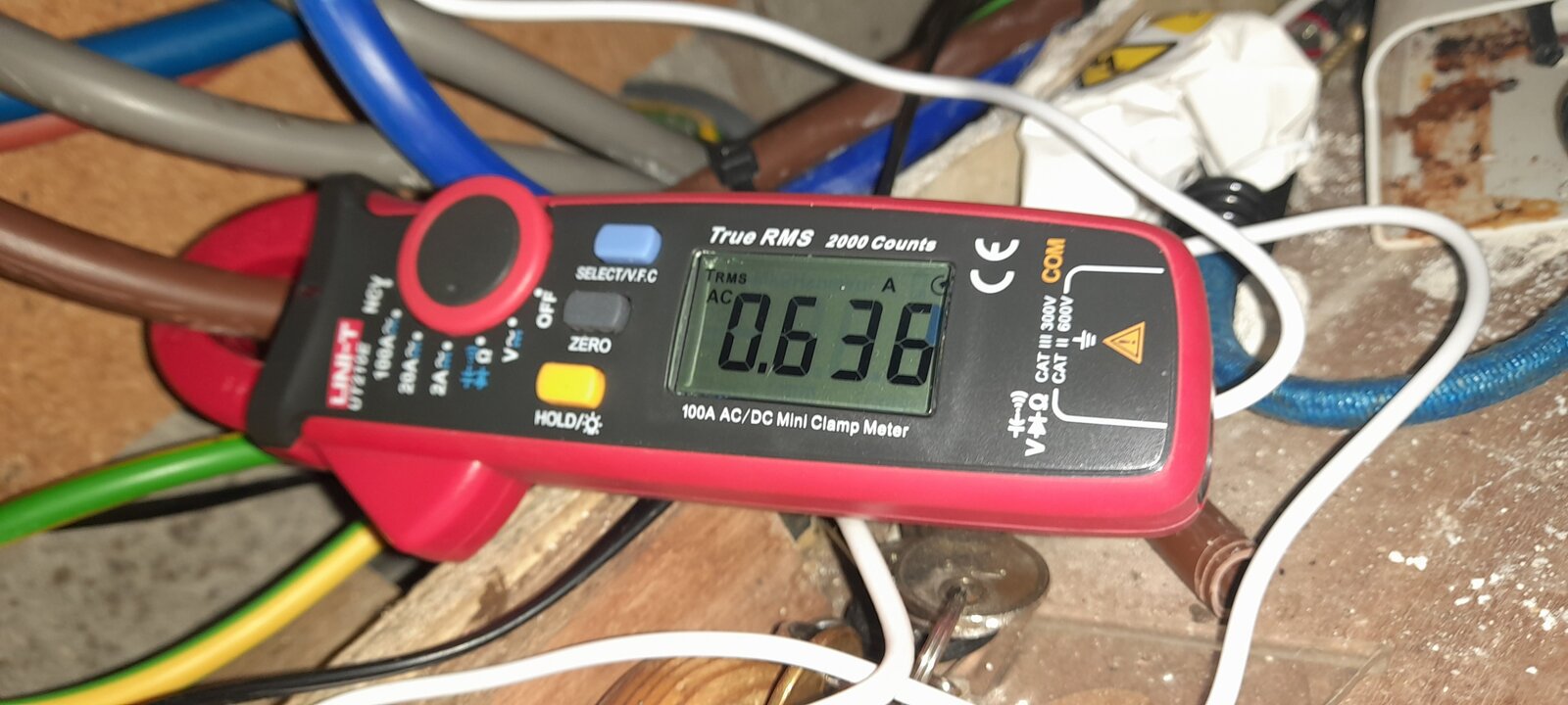

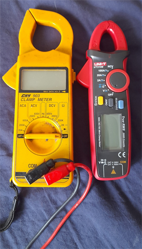

In the main I know the load each lighting set will put onto the switch, easy enough to measure, Clamp-meter-small.jpg but we are told we should consider 100 watt bulbs are used, which with LED's seems daft, but this was before LED's came out, I do watch total power used, at moment whole house using 510 watt, but drawing 4.5 kW from the grid to recharge my batteries, here I am monitoring again total house use CU use 8 Feb 24.jpg to work out how much lights use simply switch off light RCBO and see reduction in amps. But so unlikely to exceed 6 amps on lights hardly worth it.
