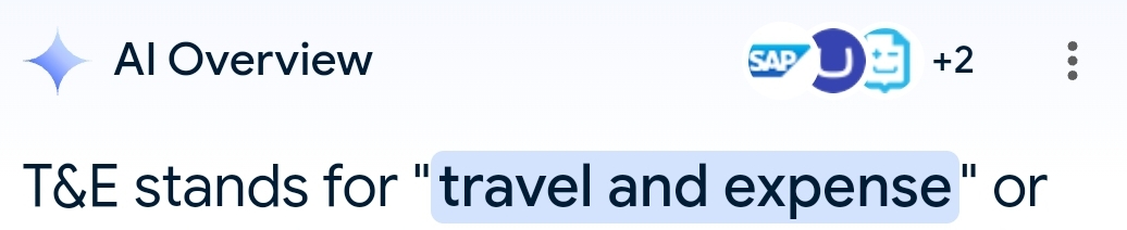

T and E most commonly is used by most folk to mean Twin and Earth but it by no means wrong for have other meanings too.
I suspect perhaps a deliberate wind up.

As a cable type, T&E only refers to Twin & Earth cable. That is an incontrovertible fact. It has never meant "Triple & Earth" or any other imagined thing. That cable type is known as three-core & Earth. It isn't shortened.
