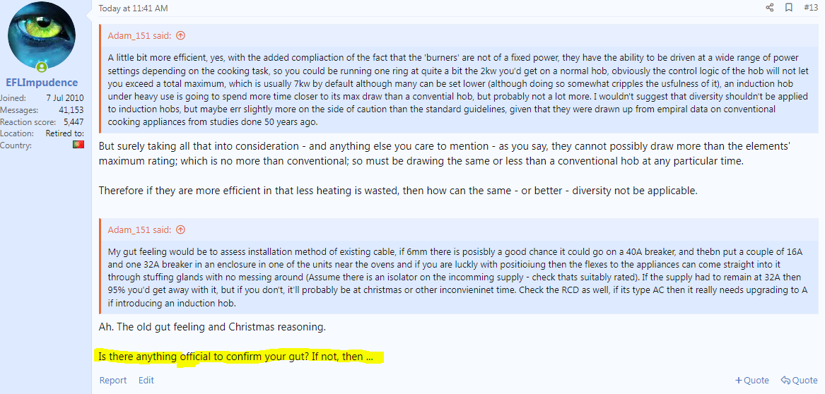

My gut feeling would be to assess installation method of existing cable, if 6mm there is posisbly a good chance it could go on a 40A breaker, and thebn put a couple of 16A and one 32A breaker in an enclosure in one of the units near the ovens and if you are luckly with positioiung then the flexes to the appliances can come straight into it through stuffing glands with no messing around (Assume there is an isolator on the incomming supply - check thats suitably rated). If the supply had to remain at 32A then 95% you'd get away with it, but if you don't, it'll probably be at christmas or other inconvieninet time. Check the RCD as well, if its type AC then it really needs upgrading to A if introducing an induction hob.
Ah. The old gut feeling and Christmas reasoning.
Is there anything official to confirm your gut? If not, then ...
Not a silly one as it goes.

Having been in the situation of a cooking appliance tripping the MCB on overcurrent during heavy use (as it happens not at Christmas) I don't think the original comment is as silly as many would seem to think.
The only 'official' confirmation of any gut feeling is circuit design within the regs for any other appliance. IE any other appliance rated at 14.95KW would not have diversity applied to it. However we all know there is a special case for cooking appliances for which
although I'd put the figure way higher at above 99% with a number of 9's after the decimal point.
Now as it happens; many many years ago I was in conversation with one of the members who helped establish the cooker diversity rules, he explained the figures used were solely to get a particular cooker (of which most at the time were very similar) compliant on 30A fuse. It had to be amended as most cooker switches included a 15A socket (Now 13A of course).
