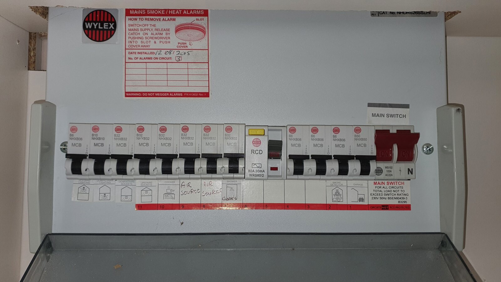

What amp circuit required for 2 ovens and a hob
Why don't you tell us what models of appliance you have in mind?
It would also be useful to see a pic of your consumer unit
And very very useful to know the size of your existing cable.
I previously had a range circuit with a 40A MCB.

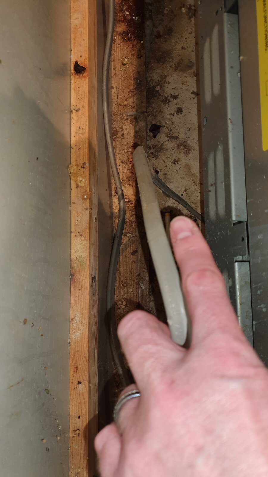

Not sure on cable size as unable to pull stove out to check and its the only place its exposed.
See consumer unit attached

Picture of cable. It looks thick but i know nothing.
You could try to measure it (accurately)
The easiest way I know to identify cables you don't see often (4mm for example) is to have a few cable clips in various sizes, and test which one fits easily, but tightly enough to need your thumb to get it off.
I don't know if DIY sheds sell mixed packs.
Trainers often have a board with a range of types and sizes clipped on to help build familiarity.
If you're in a shed, hold your measure against a few sizes and take a close up photo. Do the same with your own, and somebody will know what it is (it's PVC T&E, by the way)
Nominal sizes on here
A 6mm cable is probably what you've got. I can't see if it's plastered into a wall or packed in insulation.
