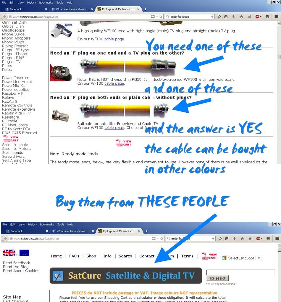

What are these cables coming through my wall? And what cables do i need?

I posted a link to what you need in reply #10 (see the Satcure page link). Simples
Ahh damnit, you beat me to it.
I was about to say i think i've got the right one & it's that very one :oops: I took a look at that website on my dinner break & was a bit lost by it. It was only after i posted my last post did i look at it again on PC this time & had more time to read & figured that must be the one.
Sorry about that :)
Although i don't get why you say "AND one of these" pointing to the one underneath?
I would've thought the top one would've done perfectly fine - one end plugging in to that splitter, trail the cable to the TV location & plug the other end direct in to the rear of the TV, job done?
That's what i thought anyway. So where does that second cable feature in all of this?
Note: I noticed about the colours :p:p Ordered black :)
Placed the order after my last post but before reading your last one. So hope i don't NEED that second cable you point to.
Someone already gave you a link to the SatCure site and that site has a built-in search facility. However, to save your time, here is a direct link to the WF100 page: http://www.satcure.co.uk/accs/WF100_cable.htm#tvf

But anyway, I don't get why Lucid said I need "AND one of these". I thought the first item (which I've ordered) would've done just fine on its own?
So why doesn't it?
So why doesn't it?
I just used an old image and hosted it last night. I should have added a note that all you needed was the top lead. It was late and I was doing some other stuff at the same time so not really paying attention.
Like Winston1 said, if theres no power supply inline and you're going from the splitter to the TV then all you need is the F to TV coax plug lead. There... done. :)

Thank you Lucid. The "and" part really threw me, but at least that's that sorted.
