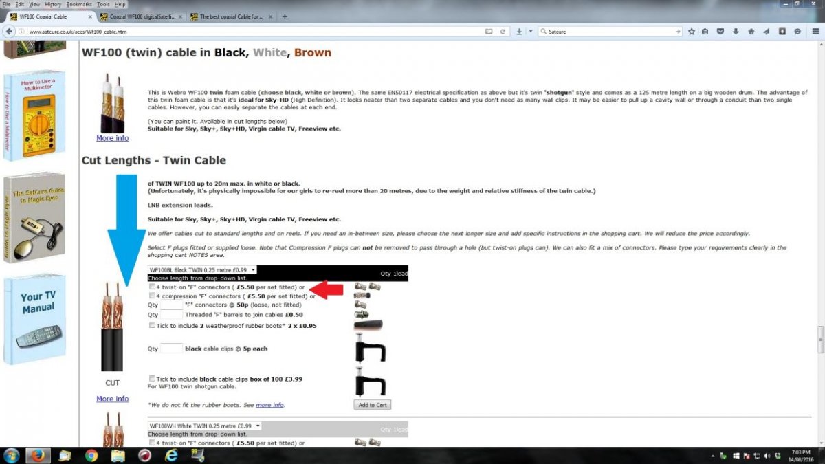

Got Sky installed today. I want to do the same thing with Sky that i've done with the TV aerial cable so i'm just looking for an extension basically.
The connectors on the ends of the Sky cabling are F connectors, so i believe i just need F-F cable that is suitable for satellite/Sky.
So jumping back on Satcure, is it the cabling i've arrowed up...
I'm fairly sure it is that but i want to be 100% sure before i send payment & then wish i'd have asked.
If it is that stuff then would you opt for the twist-on or compression connector & why would you choose said one?
Is it the type and colour that you want?
If it is, then, yes.
I see that it's twin cable. Do you need twin? Do you prefer it to two singles? Did you choose WF100 for minimum signal loss, instead of WF65, which is thinner and more flexible?
I'm not overly fussed about the colour. That'd be my wifes area :D I just wanted to know if i'd selected the right type of cable that would act as a Sky cable extension.
If i've understood right then that WF100 will also do Sky cabling as well & is the best for the job really, so that's why i selected it.
The cable that comes from under the floor is just whatever Sky supplied. I want it to stop at the floor & have a small 0.5mtr cable that runs from Sky box to connect to the end that comes out of the floor so that there isn't just one big cable pulling up beyond the carpet etc.
WF65 "shotgun" cable will be fine for such a short length and is more flexible.
Compression every time. They have better matching (less return loss) and are more reliable. They don't tend to unscrew off the cable as you fit it to your sky box either. Cable companies use them because they are the best. Sky installers use twist on types because they are not engineers.
We are going to have to disagree on this, unless you can direct me to your peer-reviewed test results. (I have never found any test measurements comparing the two types.)
Correctly chosen and correctly fitted twist-on types will never unscrew without considerable force being necessary.
I grant you they are not "engineers" but the reasons that Sky issue twist-on connectors are that:
1. They work adequately and reliably.
2. They are cheap.
3. They need no special tools.
