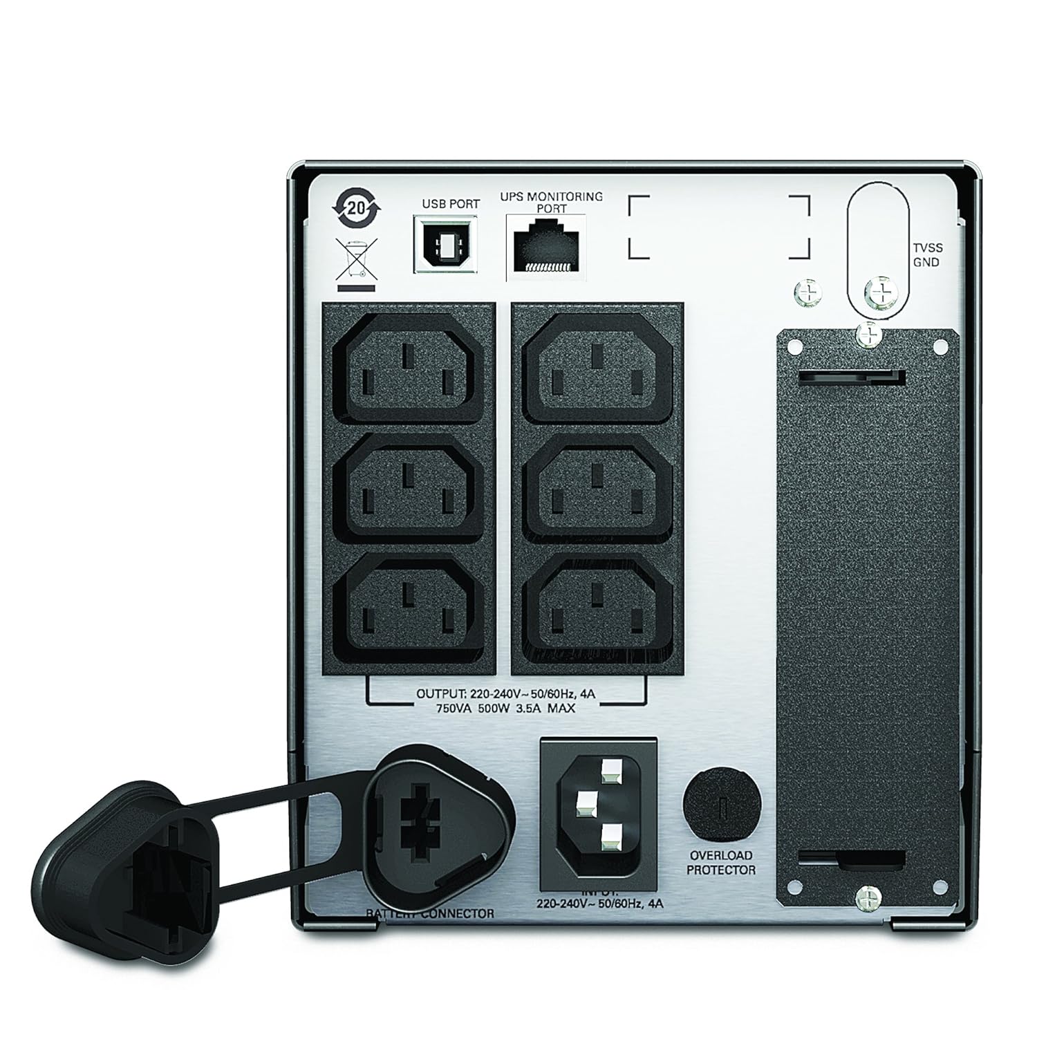

My UPS is the typical one with IEC outputs and a IEC Input similar to this; it is above the 6U network cabinet on it's side on a large shelf. The network cabinet what is supplementary bonded back to the FCU feeding the UPS feeds a couple of switches, Single bay NAS drive, USB Printer server, and the socket in the room upstairs.
When disconnected from the mains, the UPS Voltage is as follows:
L-N 243V
N-E 125V
E-L 118V
Would a typical FCU RCD not work then because of the low voltage between Earth and Line, where Earth appears it may be the centre tap of the step-up transformer. What would be the easiest and cheapest thing for me to do?

The picture of the back of the UPS
shows TVSS GND (transient voltage surge-suppression) but this it seems is to ground things to the UPS the UPS still uses the earth connection from the supply lead, as to using the supply lead for earth when there has been a loss of power there seems an error with that since if unplugged it would not have the supply earth and to have the earth pin of a plug go live is clearly not what it wanted. So any earth would need to be connected with a tool so it could not be simply unplugged. Likely connecting an earth rod or at least something which is already bonded to the TVSS GND would provide a ground independent of the plug, but it may not be connected to the output under power failure anyway.
As I said before we need to assess the risk, and it seems likely that the supply socket is RCD protected, so any item plugged into the UPS which has an earth fault would cause the RCD to trip and the UPS to take over. So it is likely the UPS could have a single fault to start with, the single fault is not a danger as which ever line it earths does not matter the fault will not cause a shock. What is the problem is a second fault could result in a shock, so we need to consider what the UPS is supplying.
