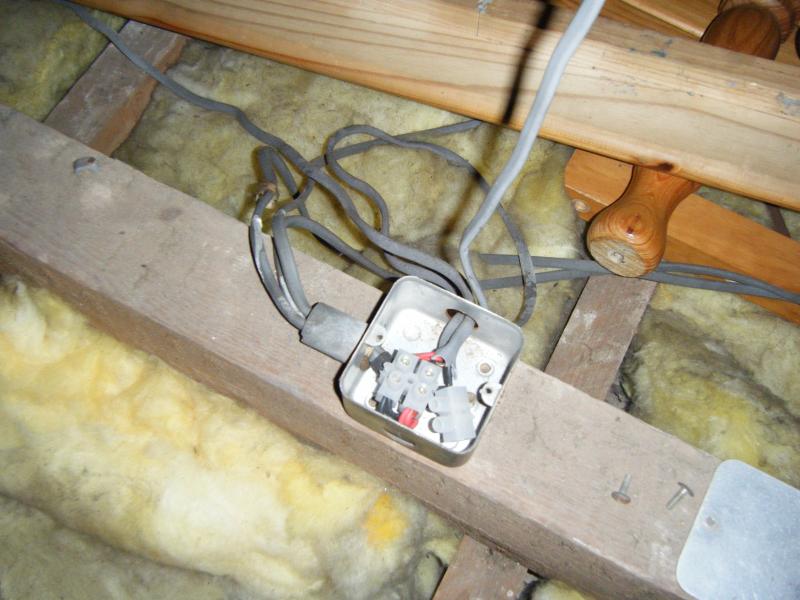

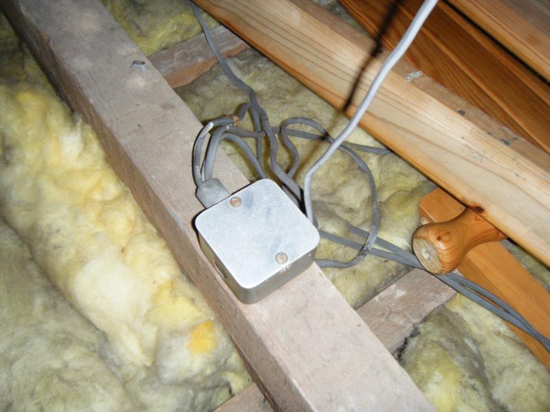

I know that you like pictures on this forum from time to time - I have this in my attic screwed to one of the beams. Never had any problems it but it doesn't look very clever.
One of the cables running in is most probably from the CU but I haven't checked. The rest of the cables run off to the upstairs lights.
The cable running vertically that you can see runs to the attic light. Rather, annoyingly, there's no ceiling light in the master bedroom so we must make do with table lamps.
Needless to say the rather strange metalclad arrangement is not earthed. All of the earth wires in the T+E cables have been cut back on the lighting circuits.
House was built in the 1960's, lived in it since '97.

Not the worst I've seen but the cables need glanding properly with some sort of strain relief and the metal box needs to be earthed (if not already)
The metal enclosure must be earthed, if the cpcs have indeed been cut off at every point as you state then this could be problem-some, you will need to see if you can get hold of enough slack at points and strip back the cables to get hold of the earth, after thats done, the circuit should be tested to ensure you have got a continious earth (the one thing worse than not having an earth connected to a class 1 fitting, is having an earth connected that is floating open circuit)
Do you have any metal light fittings?, Do your switch back boxes have nylon blocks for the screws to go into?
Other than that, the cables could use some clips to provide strain releif near to the box, and it looks like it requires some grommets...

From what I can see in picture main problem is lack of cable clips or stuffing glands so one could pull a cable out of box. Also no sign of box being earthed.
But in the loft space that is not very likely it will cause you a problem and although not right it's not too bad.
If you use loft for storage then it needs fixing, but if not I would leave until you have an electrician to do another job and ask him to do that at same time.

There's enough slack in all of those sheathed cables to strip them back and restore the cpc's (earth cores). You could also do away with that metalclad box and replace it with a standard 30A joint box (20A would do, but 30A has greater space for multi-cable terminations).
Strain relief for cable entries is a simple matter of clipping the cables as they enter the enclosure.
Your main problem here is that the cpc's might well be snipped off at their respective opposite ends. As a DIYer, you don't need sophisticated test meters to prove the effective connection of the earthing to the primary feed cable - a simple test lamp will do for DIY.......
